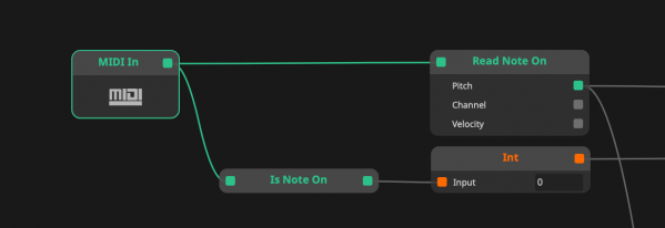

Hi everyone. I just made a Wire patch that paints vertical lines when you press any key on a MIDI keyboard. The color and position of those lines depend on the note you're pressing.
So far so good, but it's "monophonic", meaning pressing two keys doesn't work, only the latest keypress is used. I'm using MIDI In > Read Note On to get the keypress, but no matter how many keys I press, I only get one number out of it.
Does Wire support MIDI poliphonic keypress?

All midi events arrive into Wire, I guess you're feeding them into a Signal node, which only gets processed once per render.
You might be able to add a buffer in line with the events, to store them, like a Stack for example.
If you share more of your patch we might be able to help better.

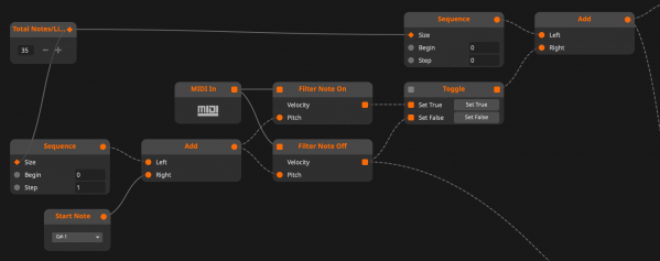

Re: Wire - Poliphonic MIDI in?
Guys have a look at this patch viewtopic.php?p=100274#p100274 I think that will help you both out.
And here is just the polyphonic MIDI part:

Using the toggle node in combination with the filter node solves this issue, thanks Tijn.
Here is my patch, with moving lines instead of using the alpha
