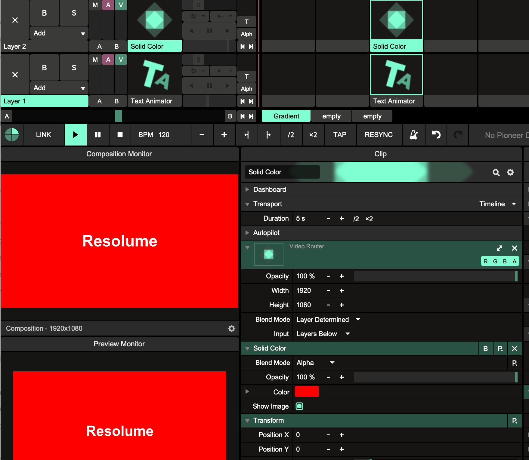

Re: Apply Lumakey to composite and see mask?
The Solid color effect with show image enabled could be used to put a color behind a transparent clip. Won't be as flexible and you can't play videos, but a single color can be done.
