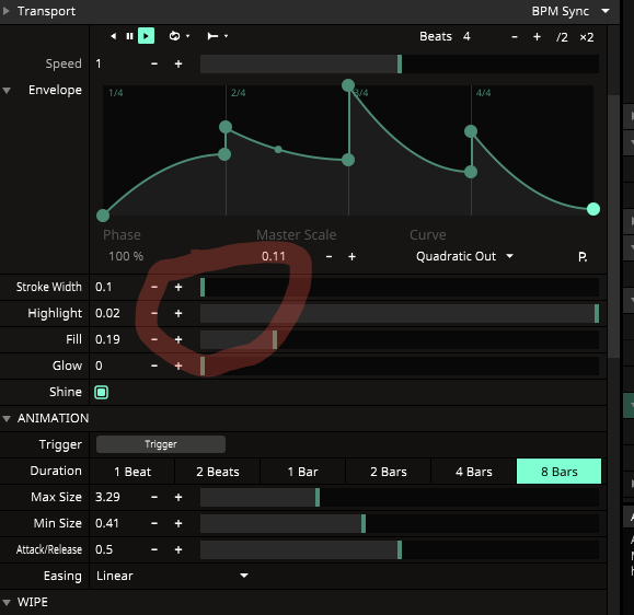

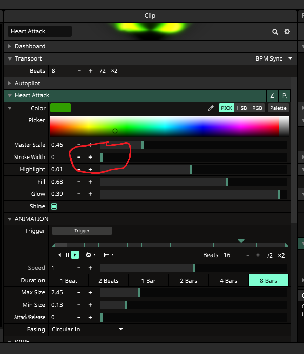

I have a Wire source with a parameter on its dashboard that runs from 0 to 0.2
Once I'm using the patch in Resolume, "sometimes" that same parameter only goes as low as 0.1
Even within the same Resolume composition, the same Wire source on different clips will have instances where the parameter has its full range, and in other clips it doesn't.
The first time I encountered this, I had the patch already open in Wire. Despite the patch already being saved, I saved it again, and that magically fixed the problem in Resolume.
On closing and reopening Resolume, I encountered the same problem again
The images show the exact same Wire source in the same Resolume Comp.

it only goes down to 0.1.

I figured out that the issue is caused by presets.
There were some presets for an earlier iteration of the same source that had been saved in Arena. If one of those presets was used on the newer iteration, the problem occurred so I guess it's a bug related to saving presets in Arena and then altering the source in Wire.
