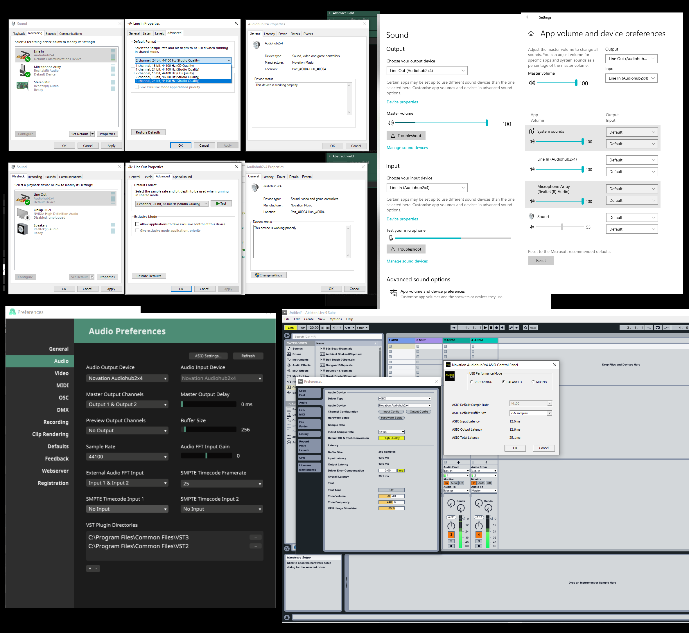

Re: Audio issues after update
I've checked everywhere I can think of. See the image. Maybe I'm missing somewhere? Windows is acomplete nigthtmare for navigating these things!
Everything as far as I can see, is set up as it should.
Ableton has no issues whatsoever.
The Novation Audiohub window on the Ableton interface, is what I think fails to open when I click on ASIO Settings from Resolume.
As I pointed out, everything was working before the Resolume update to 7.24.1, so I'm inclined to think the problem lies there but I could be wrong.
