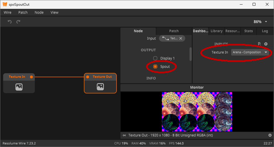

Very basic Wire "Effect". Texture In node is using the Spout output from Resolume. The Texture Out node has Output > Spout active.

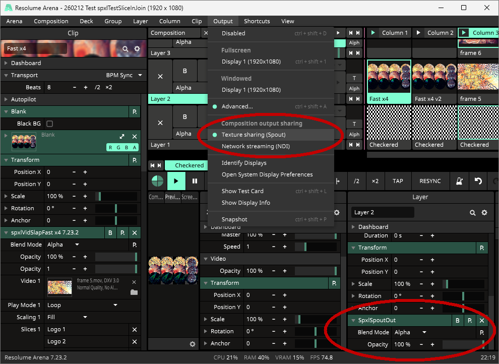

Resolume (Arena) with Output > Texture Sharing (Spout) enabled, and the spxlSpoutOut effect active on Layer 2.

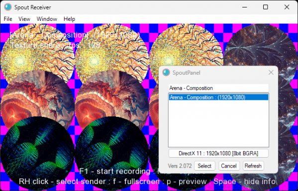

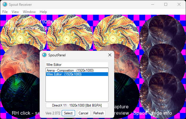

With Resolume and Wire both open, the demo Spout Receiver program shows only the standard Resolume texture sharing output and the Wire Editor output.
With only Resolume open, the demo Spout Receiver program shows only the standard Resolume texture sharing output.
