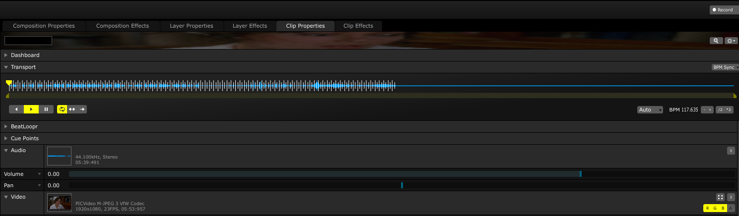

I have a long (5 min) 1080p avi, I need to work with three such sized clips simultainiuosly running for much longer than 5 min's, the avi seems to load completely, but is missing approximatily half it's content, when it's played it 's obvious that the file has become corrupted from about half way through.
Is this caused by unusally long clips? or large file sizes? The footage was eddited in After effects and then rendered in the normal way using Pic video compression, when played back in After Effects there is no sign of any corruption.

- 2009-07-26_142704.png (95.5 KiB) Viewed 8019 times

Please do send us a small portion of the file. Is the audio the only part that is missing or also video. It might have something wether the file is mono or stereo. But we can only know for sure if we have the file ourselves.

The clip (where it appears flat in the pic) is actually just looping a single frame, I've seen this happen before now I come to think of it, the file is an AVI thats been converted from an HD - EVO VC-1 to H264 then again to Mpeg/AVI.

VFW Avi files have a 2GB limit. Files bigger then that will give unexepected results.
