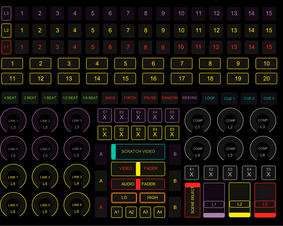

OK...here is the deal. i have uploaded the layout i am working on. i have not been able to find the OSC commands for the middle row of the layout. i would like them to be activelayer commands, but everything i have tried has no response.
Once i get these commands i will put on my website with the OSC patch for free download.
everything else works, just need the row starting with 4 beat and ending with cue 3. also need tosetup ableton live side so i can give to everyone else to enjoy.
i know, i must be stupid. just trying to learn and share with everybody.

The OSC commands for that row of buttons can only be assigned to individual clips (ie /layer1/clip1/video/position/jumptopointofinterest = 4 to jump to the fourth cue point of the first clip in layer one).
Perhaps a workaround is to make a slider that selects which clip is targeted?

i see. the buttons on the left of layer rows are layer select buttons.
/layer#/select
what will happen if i put a row of 15 clip select buttons
/activelayer/clip#/select
then for the the 4 Beat button
/activeclip/video/beatloop#
# = LAYER or CLIP #
would this work?
thanx for the help
Re: iPad controller in progress/need help
That's pretty much what I had in mind as well. Theoretically, it *should* work.
