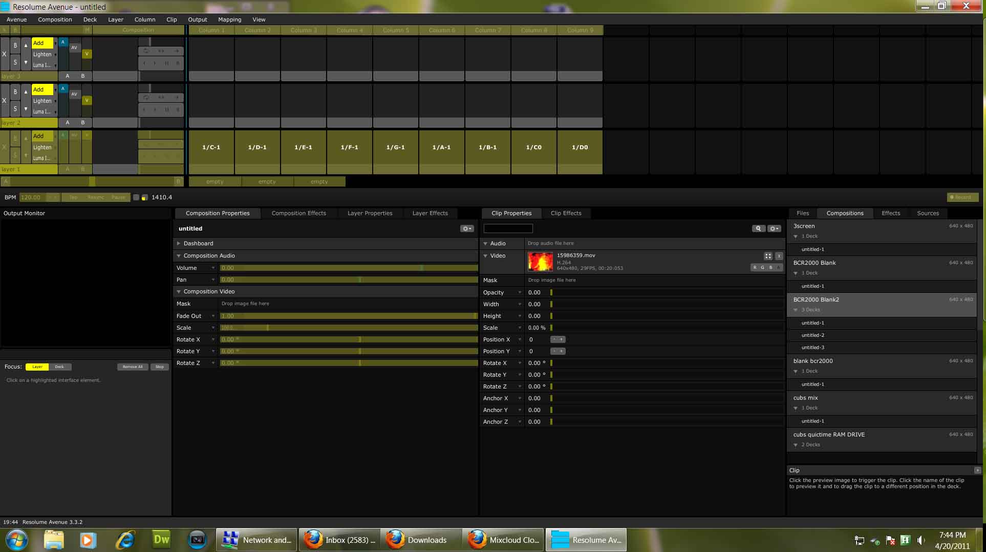

I've had this issue with 3 versions of resolume now (3.2, 3.3.1, 3.3.2). Resolume does not allow me to map a number of features. You can see the features that cannot be mapped are not highlighted in the attached pic. I've tried deleting the Resolume Avenue folder in My Documents and then launching a fresh install of 3.3.2 with no luck. I've also had issue with Resolume not saving the map settings that took me an hour and a half to setup. I have not tested this with 3.3.2

There are one or two features that can never be midi mapped because it could cause unwanted behaviour ('remove video' is one that comes to mind). But it sounds like you want to map in deck focus. Enter Application Midi Map mode, and choose deck focus in the bottom left. All of the clips and layers will become accessible.

I've tried your suggestion without any luck. Doesnt matter if any clips are loaded in the decks or not. These features work perfect with composition midi maping. Please help!

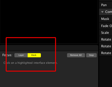

I'm sorry, but I can't find anything marked "Layer X" in the interface, or in the screenshot I posted. I'm referring to the mapping focus switch between Layer and Deck in the far bottom left of the interface, which you can see outlined in red when you scroll down on the screenshot. I'll attach a close up screenshot, again outlined in red.

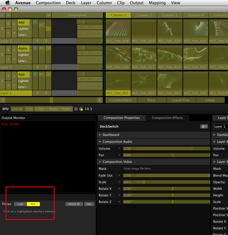

On similar subject... i use Mac and MIDI control with APC40. i can map clips to buttons but was hopeful to find a way to use the Bank Select feature to move the "yellow Highlight box" around the field of clips and pan up or down through layers. i now do this with my track ball thumb mouse from logitech. I know the scroll up down and right left is not mappable is this and update item Resolume could supply in the future.
