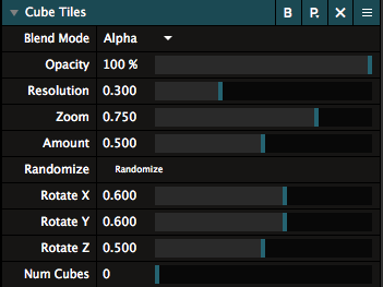

Occasionally, you will come across an event button in an effect as well. For instance, the Cube Tiles effect has an event called Randomize, which randomly re-arranges how the tiles are distributed across the cube.

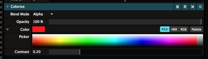

Color
Color is a very important aspect of visual performance. Maybe the most important.
Resolume gives you fine grained control over color. Wherever color is used, Resolume will show a special UI item to set it.
The default view is a standard color picker. Simply move your mouse to pick the exact color that feels right to you.

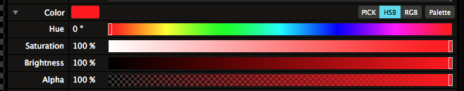

If you're more of a number person, you can also set the the color using RGB or HSB sliders. In these mode, you can get the color you want by entering the exact Red, Green and Blue, or Hue, Saturation and Brightness values. Using sliders gives you the added advantage of parameter animation, and an extra slider for the alpha value.
