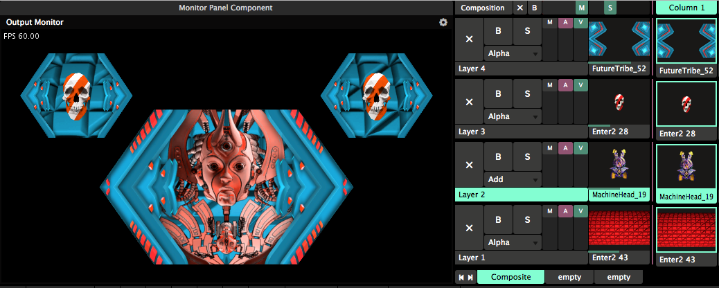

By far the cleanest way to paint is to use content with an alpha channel. Clips with an alpha channel have transparency baked into them, so you can stack layers on top of each other, without mixing the paint. This way, you can precisely control which pixels to show and which ones to hide, while the overall composite stays crisp and clean.
Most of the content you purchase in the Resolume shop has an alpha channel. If your content doesn't, you can use the Auto Mask effect to turn the black pixels transparent. You will need to play around with the Contrast parameter to get the desired result.
A good way to approach a composition with alpha channels is to use a Background / Focus / Frame approach.
Your first layer will be your Background. You use this layer to paint the entire canvas with a screen filling loop. This gives your composition texture, and a base to start with. Abstract loops with some kind of pattern are great for this.
On top of this, you use the second layer to paint a more recognisable element. This is to grab the viewer's Focus. Faces are always a winner, but you can use anything that has some connection to the music or theme of the stage. If you're commercial oriented, this would be a great place for the DJ's logo.
The third layer will be used to Frame what's underneath. The layer will be used as a window, blocking some parts of the content underneath. Often used in movies, blocking the layers below gives a sense of depth to the overall composition, and constantly hiding and revealing parts of the composition keeps everything dynamic.
Of course, nothing is stopping you from using more layers, or even using multiple focus points on a more complex stage design.
