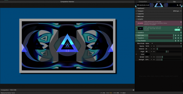

Re: Frame around video / image
Post by mowgli »
Put a second transform after the solid colour and resize with that.
You can subscribe to my YouTube channel for Resolume tutorials.
https://www.youtube.com/channel/UCi-Y7A ... irmation=1
Post by brinkoko »
mowgli wrote: Sat Mar 08, 2025 14:55 Put a second transform after the solid colour and resize with that.
It worked! Thanks both for the advice!
