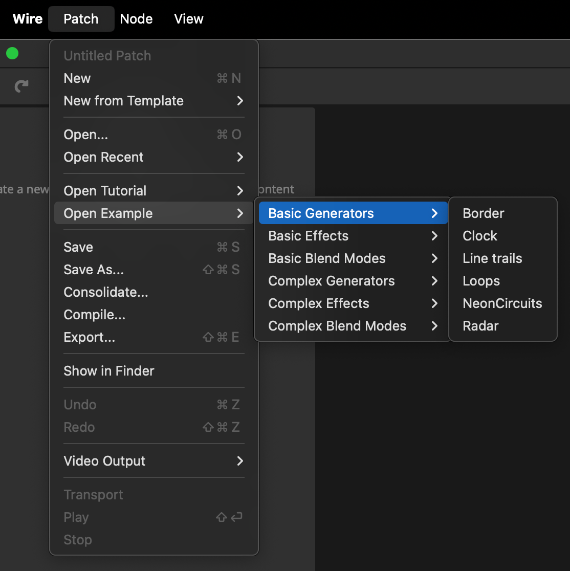

This is definitely something that wire will shine in and can do some nice stuff. I think the best place to start would be the Resolume YouTube page https://www.youtube.com/watch?v=Aq3PEoa ... M1y_dlBf0Q and Wire itself. There are loads of tutorials and examples inside of Wire and every node has his own documentation as well. You can just open those patches and play around with them to start with.. And if you have any questions, don't hesitate to ask it here or on our Slack Channel : https://join.slack.com/t/resolumecommun ... N5T414CDaA
