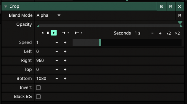

There is no fade for the bypass-button. You could however animate the opacity-fader with play once and hold and make shortcuts for those 2 little forward- and backward buttons. Or you animate the other crop parameters, if you don't want to have a blend but a smooth transform from one crop to the other.

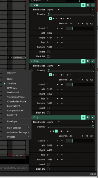

So, moving between these options is quite clunky. I have the option to make commands wait for one to finish etc.
This is a screeny of the three crop options I want for this layer, and there's going to be the same for two other layers. Have you got a 'best practice' idea for how to time it so I'm not seeing three crops adjust at the same time?

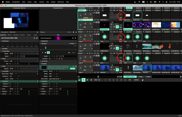

Would it be a idea to make three groups - put the three crop effects as separate clips on the top layer in every group - put that layer's blend mode on cut so you will only see that layer. Then you can trigger the difference crops and even fade between them with the layer transitions. Or go fancy and use some other transition.
If you use groups, you could even decide to not use a crop effect, but just simple solid white squares as a mask.
This set up will also allow you to easily map the different clips/crops/solids to buttons, and you can also map the transition time and different transition modes if you would like. I hope this helps you out.
I included a screenshot of how I would shut it up:
