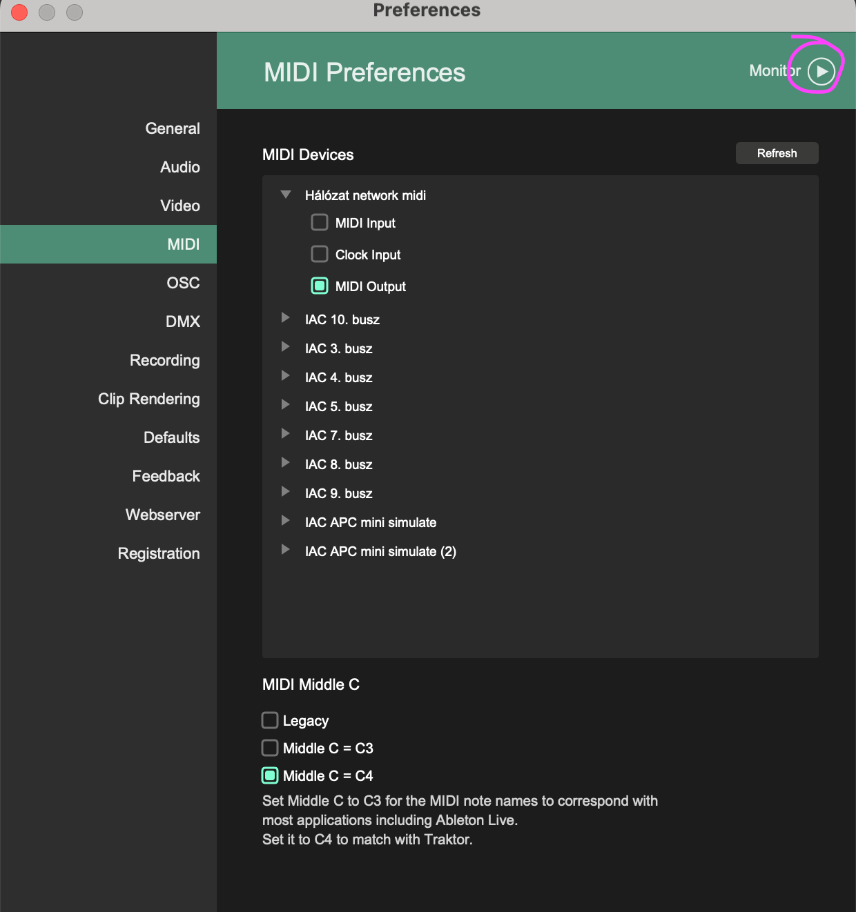

I read about a MIDI monitor under preferences but actually I din't find it, can you send a screenshot of where I can find it please? It would be nice to see if the MIDI note is received anyway when Arena stop to work.

click here for the monitor:

When the software get stucked, there's not any signal on the "monitor", neither the clock signal that you can usually see. It seems to be disconnected.
