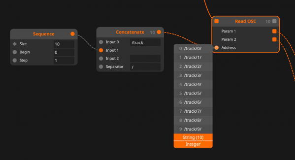

Instancing is great. ... but hard with incoming data.
Included a simple patch where incoming data is moving two simple circles on the screen.
What if the incoming data grows to more items, then instancing would be the way to go.
OSC data is
/track/0/ 45 56
/track/1/ 56 3
/track/2/ 10 67
and so on... the 0 to 2 should control a certain index. How?

Thanks in advance
OSC data controlling instances

Re: OSC data controlling instances
@zoltan sorry, I forgot to thank you, THANK YOU!
this saves a us a lot of time
