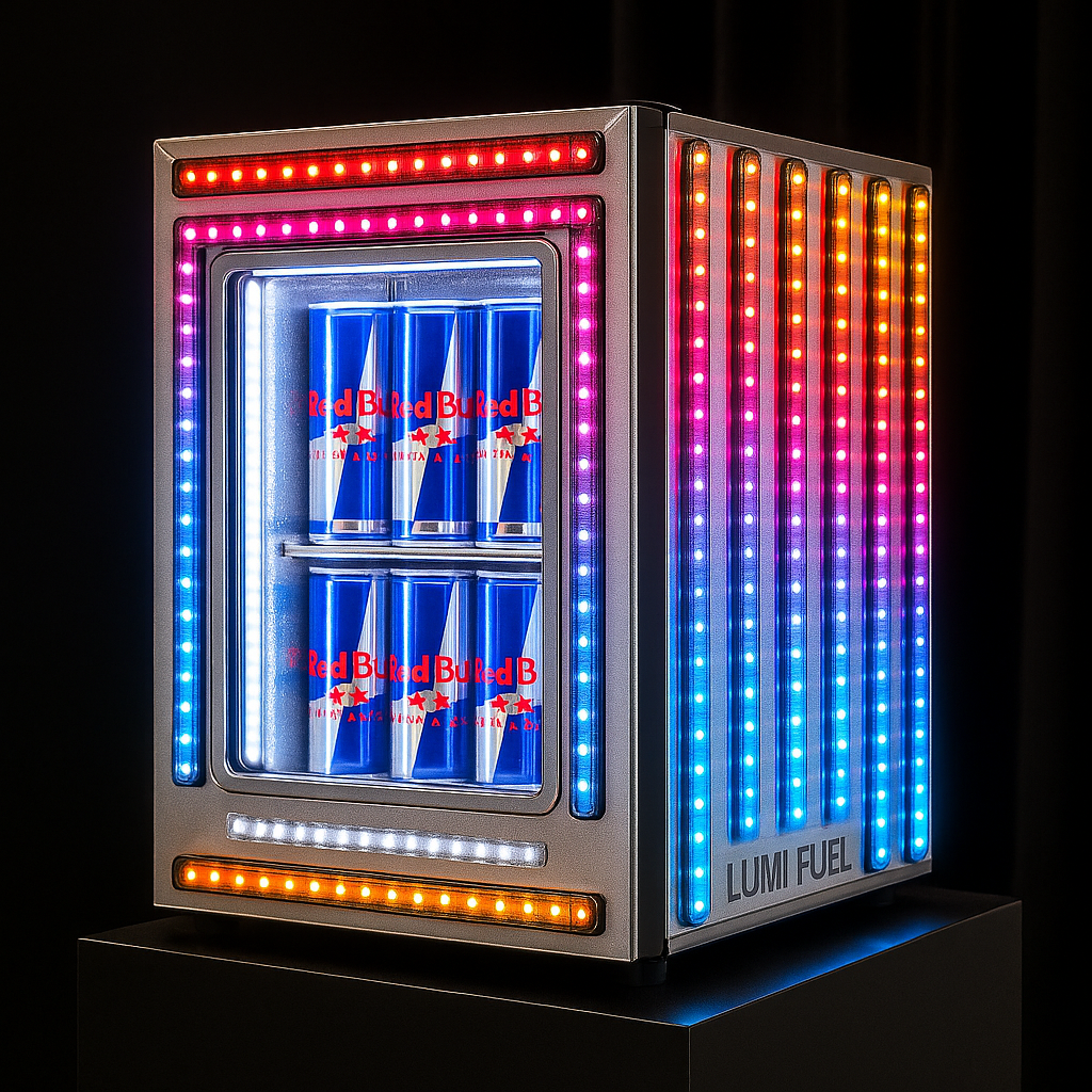

]Hi all, I’m looking to hire someone for a quick consulting session to help me set up a pixel-mapped LED layout in Resolume for an art installation. The project uses a Red Bull cooler (344mm x 390mm x 422mm) wrapped with individually addressable LED strips, mapped as a continuous run around the cube’s perimeter. The LEDs are driven by an ENTTEC OCTO → S-Play, and I need help building the correct fixture layout, addressing, and mapping the strip path inside Resolume.
It’s a tight timeline for this project, so I’m hoping to connect with someone who has experience with DMX pixel mapping, Resolume fixture creation, and ENTTEC workflows. Happy to pay for your time. Please DM me if available! I would like to have this meeting either on Thursday (free all day before dinner), or Friday the latest. Could be Saturday in a pinch, but that's feeling a bit too late... Possible?
This is part of an artist program with a very small materials stipend. I’m just looking to hire someone for a short consult, not a full build. Just need an expert to help me set up the pixel map in Resolume.

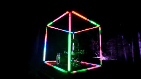

Just the Pixel map inside Resolume isnt much
Te Workflow ist shown here : https://resolume.com/support/en/playing ... #pixel-map
But first you need to do the "mapping":
Think of folding the cube to a flat surface
You may can erase the bottom one. Then place the LED Fixtures on the Layout inside the Advanced Output. You can use as many independet Fixtures as you need or as you got.
Then you either need custom content for this layout or just play some random stuff and just try n error till it looks like you want =)
More can be done when i got more information about what the result should look and what part of the job is done by others....
I once did just outlines of a cube and it was quick n dirty / try n error.. but it worked
