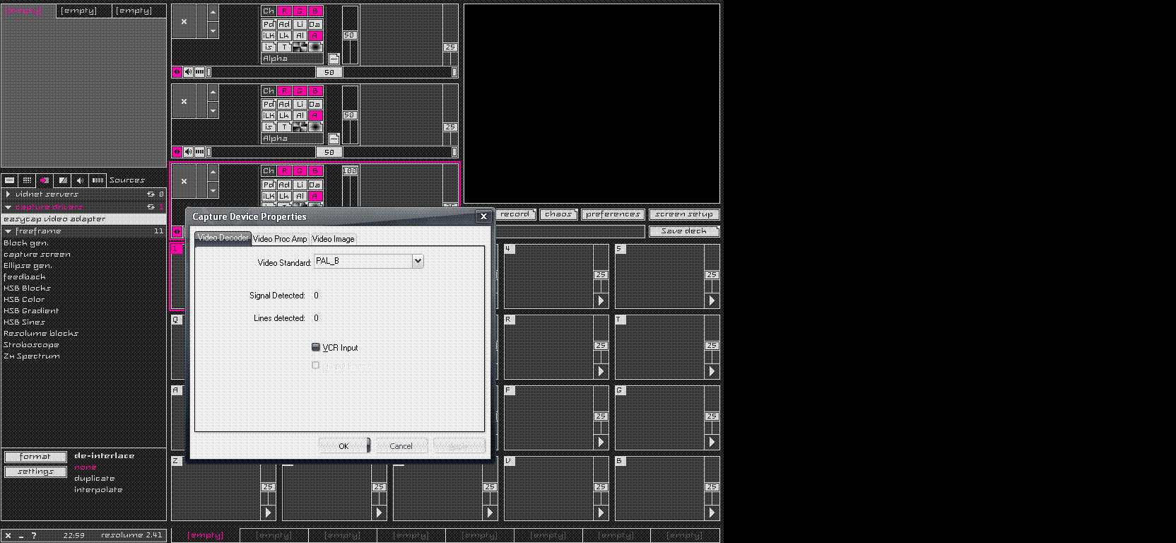

I have bought a easy cap usb device so that i can stream live video into resolume from my camcorder, however resolume does not alow you to choose the video source.

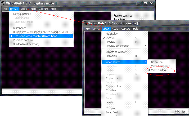

This works fine in virtual dub but it cant be done in resolume
Virtual Dub.GIF (32.41 KiB) Viewed 9758 times
I have gone into the Capture device settings in resolume but cant get any signal, and there doesnt seep to be a select source option at all.
Is there a way to choose the pin of the device?
Please help!
Maddis
