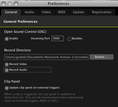

Its in the settings under general preferences. if you want to record audio from an external source (from other software), you will need to use a VST plugin called wormhole. there is a good tutorial here:

- audio pref.png (30.1 KiB) Viewed 17332 times

I don't have "record audio" or "record video" options.
Is this new to 3.1 I have 3.0.0, is the update free?
