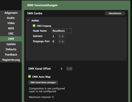

I'm using Resolume with Artnet to. On one machine everything works fine. But on another machine i got the following message on the attached DMX-Configuration sheet:
What do the error messages mean?

- What does it mean: Composition is not configured?? ...and so on...
