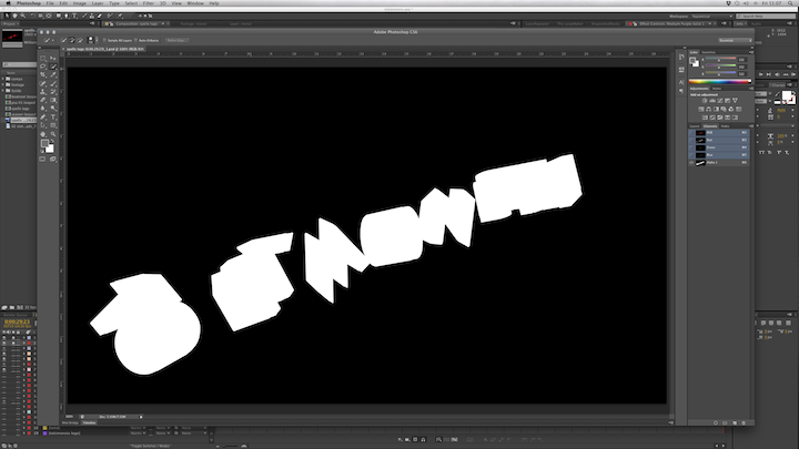

Weird because both After Effects and Photoshop show that I have a true alpha channel on my video clip. Iʻve attached an image as proof – itʻs showing all white on the parts that are visible.
Are there any other settings I should be looking for? My gig is tomorrow so any urgent help would be greatly appreciated.

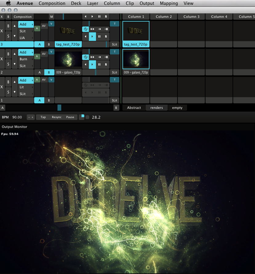

Attached are two images, one with how the alpha channel looks in After Effects, and an example of the same setup used in Resolume. As you can see, the layer blending mode is on Add, placed on the topmost layer and it still shows transparency through the layer below.

cvanhoose
Posts: 277
Re: Way to disable layer blending?
Post by cvanhoose »
Grouping, you are on both A and B.
hyp
Posts: 15
Joined: Wed Aug 22, 2012 01:02
Post by hyp »
cvanhoose wrote:Grouping, you are on both A and B.
Man, you just saved the day with that single line. Thank you good sir!
