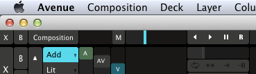

(And I just checked global speed - don't have anything set there, and it seems that'd just trigger it forwards or backwards etc, rather than changing speed significantly? or at least I couldn't see how global speed could be set to faster / slower... )
Re: Clips not playing back at correct speed?
The slider to the left of the Global Direction controls is the Global Speed control. Right clicking will reset it to 1.0.

Thanks GOTO - for the screengrab and Right-Click tip -
I can't seem to replicate the problem now, and am guessing I must've accidentally bumped the global speed...
