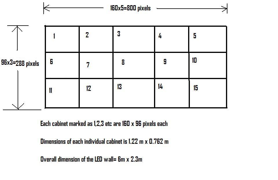

Here.... a pixelmapping from my last job so you see how it also can look like.
LINK TO PICTURE
