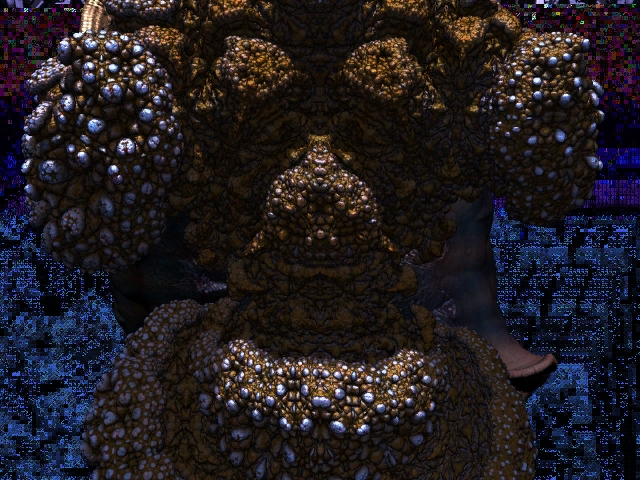

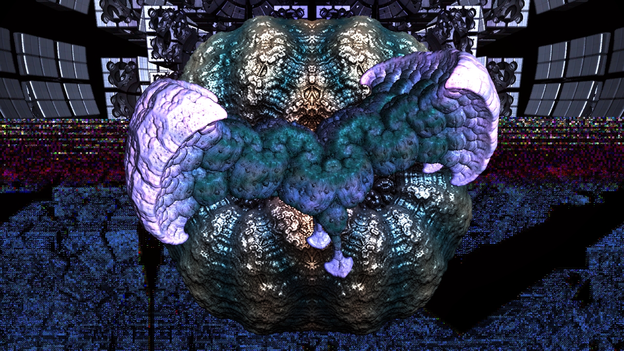

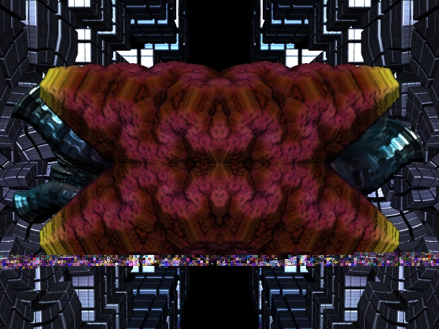

Were having a major problem with Resolume. It started after installing 4.1.4 and is now happening in 4.1.3 and 4.1.2. Were getting flickers of artifacts in the Resolume window worse when there is a heavier load on the GPU (more layers, higher resolution, DXV codec (rather than uncompressed)....)
We have our debut performance coming up in 4 weeks so if we can get this resolved asap were just going to have to drop Resolume.
I would do a complete uninstall and revert back to 4.1.3 (if it were to work for sure) but 4.1.3 was crashing when locked to midi sync.
Here are the system specs:
6 core I7 Windows machine with SSD drives
2 Quadro K5000s installed
I haven't used Resolume since February but I haven't done any driver updates or OS updates either so I'm not sure why this would be happening. I'm hoping there could be some sort fix I can do or implement soon because we really like Resolume as a server.
Here are some screen shots of the output of Resolume the artifacts are the blotchy squarish coloring. Any help would be greatly appreciated.

Okay so I've pretty found the problem and potential solutions. Basically it comes down to the DXV codec on Windows 7. I've tested this on two machines both 4.5 ghz Intel i7s one with 2 Nvidea Quadro K5000s and the other with two Quadro 5000s.
Basically when using DXV codec and playing 2 or more 60 fps 720p files the artifacts appear. This does not happen with .mov's with the following codecs animation, h.264, photo Jpeg, and mpeg4. I would prefer to use animation codec but I'm running out of disk space. All that being said Resolume's performance with any of these codecs is not very good. Here are some stats:
