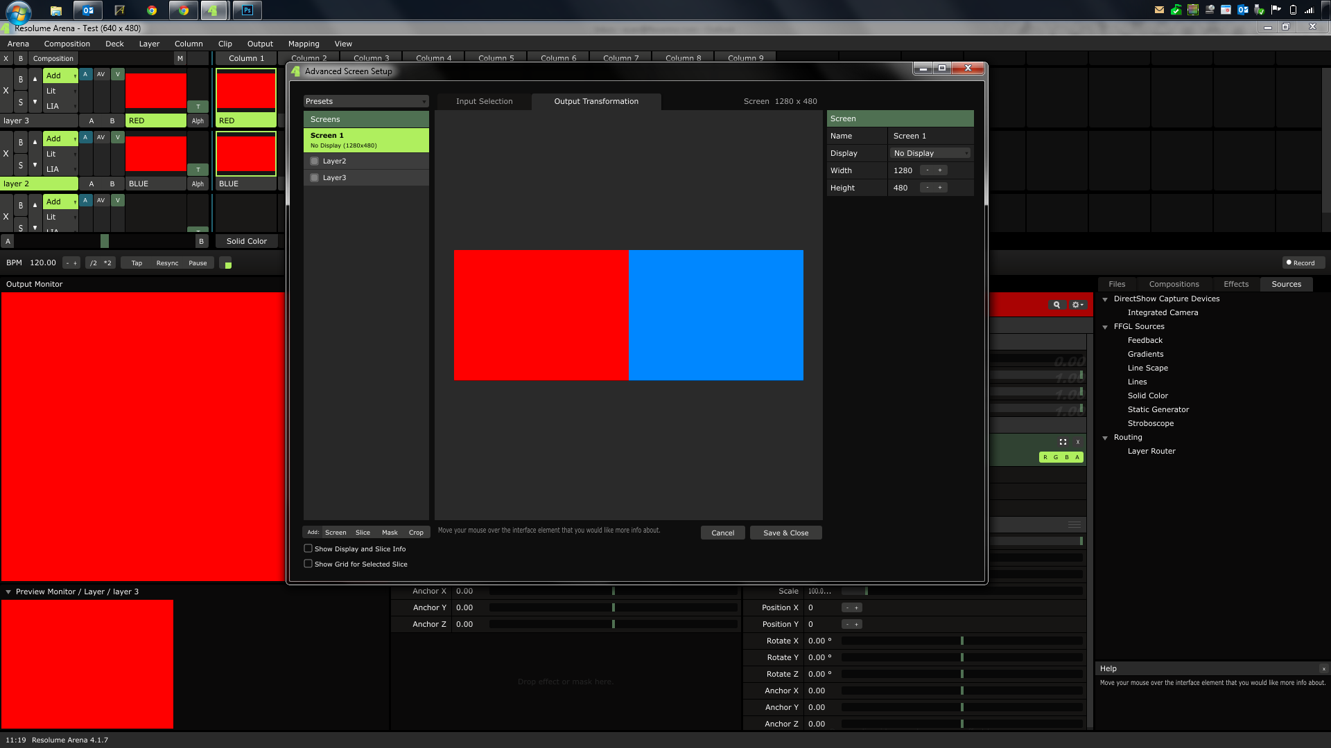

Use advanced output and slice and use the routing of input select to select a layer for the slice
Composition is 640x480. Output is 1280x480.
With a 1 output and a normal resolution (1280x720) you'll end up having to crop out some video on the input of the slice to get them to fit side by side.

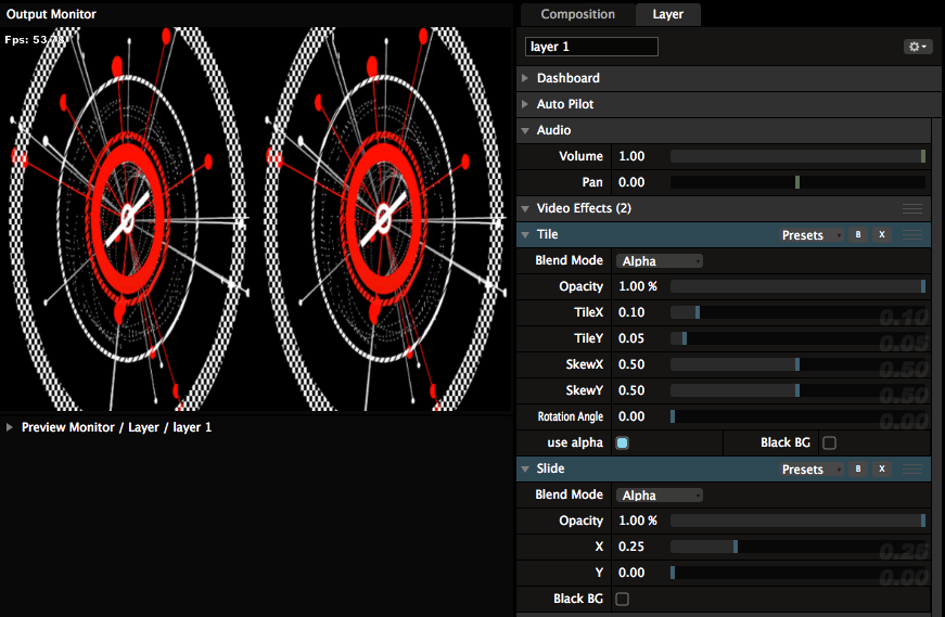

You don't mention what you want to do about the change in aspect ratio, but on Resolume 3, I think there's two options:
1. Using only native effects, you can Tile first, and then Slide. 2. Use the 3rd party FRParameters. Highly recommended plugin.
