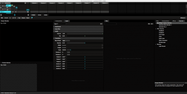

I've just installed a Black Magic Mini Monitor in my studio machine that I design and test content on. I DO NOT HAVE ANY INTENTION OF USIG THIS CARD AS AN OUTPUT FOR RESOMULE. I use this case do other preproduction purposes. However with the 9.9.3 Blackmagic Driver installed for OSX Resolume refuses to boot. If I uninstall the driver resolume boots.

I'm not sure about 9.2.2, but I think that its irrelevant. The problem is that Resolume is see in the Monitor card as a device capture input. The monitor card only has outputs! Resolume just needs to ignore this card.
After reinstalling the driver Resolume does now boot however it takes forever to boot. Uninstalling the BM drivers everything is totally fine.

All versions of the driver seem to have the same issue.
Either Crashes or Long Load times with the BlackMagic Mini Monitor (PCIe Card) installed.
I don't think the issue has any thing to do with the driver version. My Intensity Pro, DeckLink SDI, and Ultra Studio all work fine. The issue is that Resolume is seeing the Mini Monitor as a Capture Device. See the image below.
Mini Monitor is an output only device that I use Premier, Final Cut, and Motion.
Its not the end of the world if this is not resolved as I would never install this card in a system that I would use for an event. This just needs to be consider for a bug report. Preferably add "ignore bdbd:a12f Device ID" to the list of known black magic devices.

Thanks for the bug report, kmifflin. We'll look into it.
Output via BM devices is also on our roadmap, so we might hold off on an 'ignore fix' until we can properly support the device.

I figured out why this system was taking so long to load resolume. A midi driver from avid had caused the OS X midi core to crash. After removing the midi driver the system now load resolume as expected. The output card still shows up in the input devices and if you choose it as an input resolume crashes.
