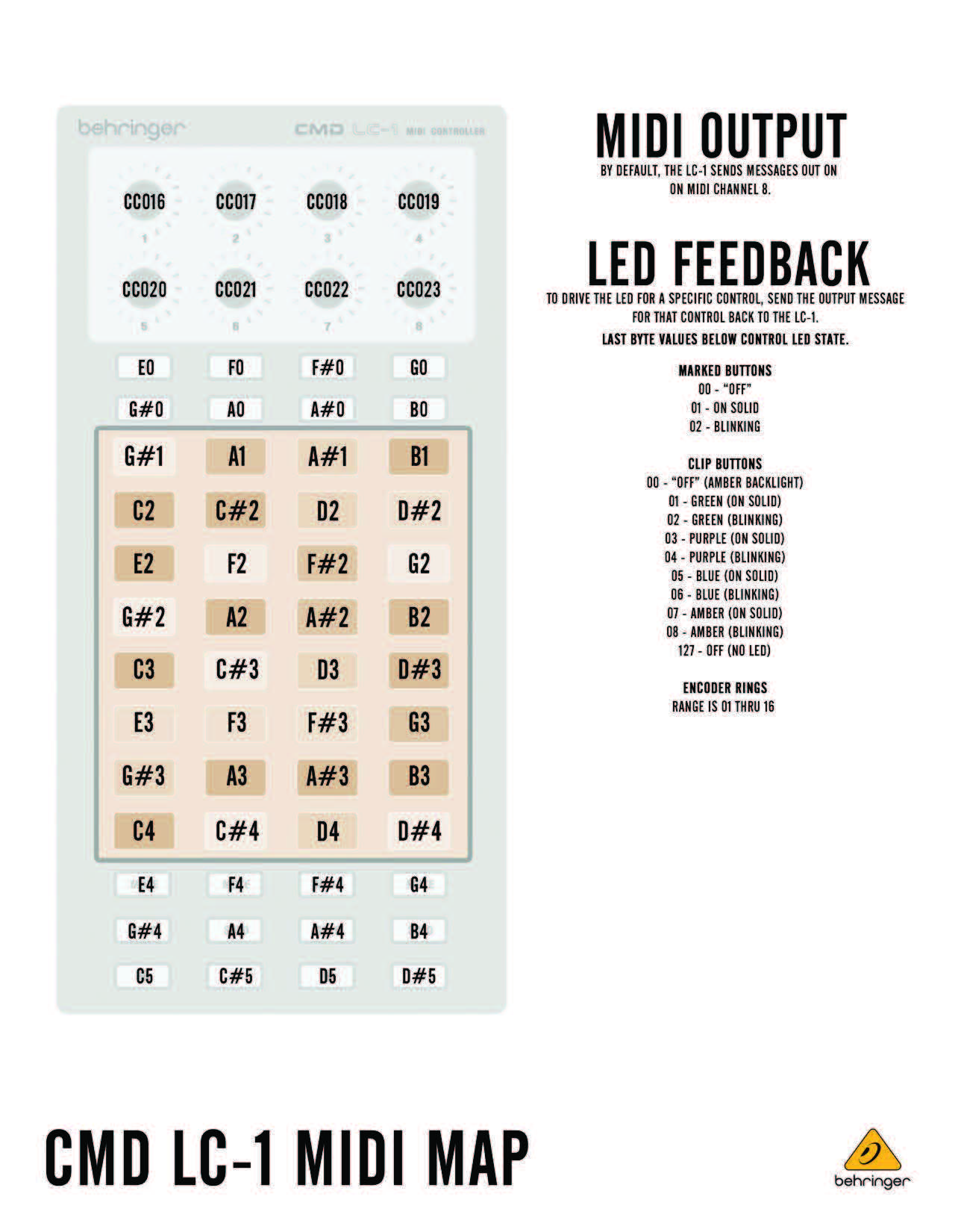

I am in the process of putting together a little patch to provide the CMD LC-1 with some feedback to trigger the various color LEDs using Bome's Midi Translator.
So far so good - it involves taking the midi velocity that resolume outputs (127 for active, 0 for inactive) and mapping that to the velocity for the colors on the controller: IE 01 for blue on the status keys or 01 for green on the clip keys.
One thing I am missing, however, is the midi event to change the global brightness. There are two states on the controller - bright and dim. I cannot find the event to trigger this for the life of me.
Does anyone have an idea of what this would be?

Behringer tech support helped with this. Pressing the bottome 4 buttons of any of their controllers will toggle between dim and bright.

any chance you could share some of this precious info on changing LC-1 button colors please

This is from Behringer. Hope it helps.

By any chance Justints did you manage to send LED feedback to the CMD with Bome's Midi Translator ?
If so, i would love to see how you did it .
