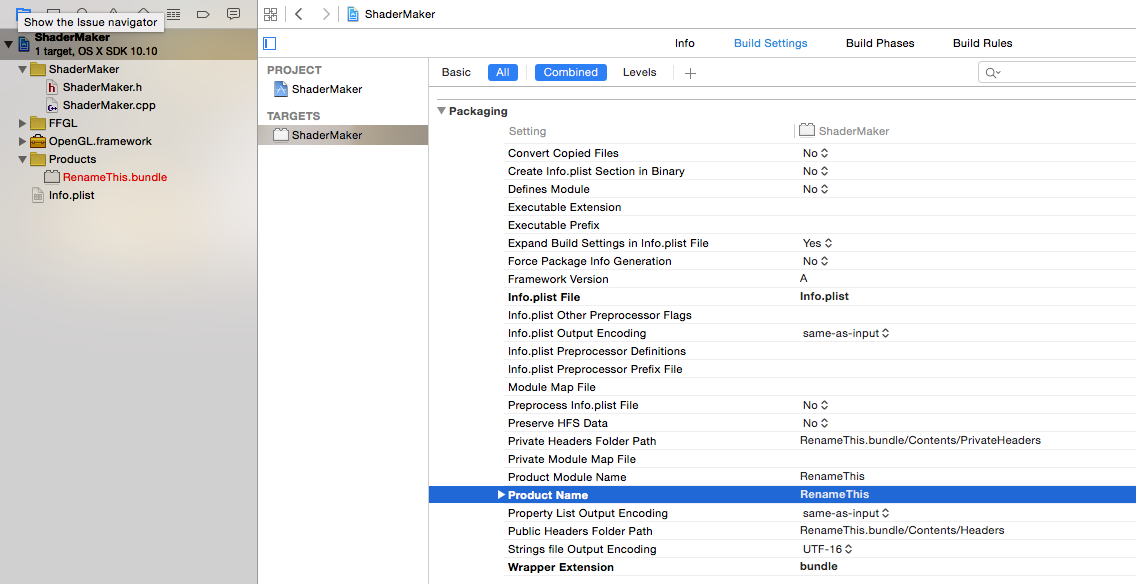

I don't think you can get away with just renaming the .bundle file like that.
When renaming Product Name in the Target Build Settings before building, things seem to go okay for me.
Re: FreeframeGL ShaderLoader
That's good to know, thanks Joris. The readme mentions just renaming the file itself which is what caused some confusion. Will definitely try that.
Update: Worked great!
