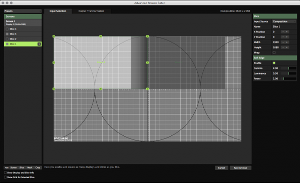

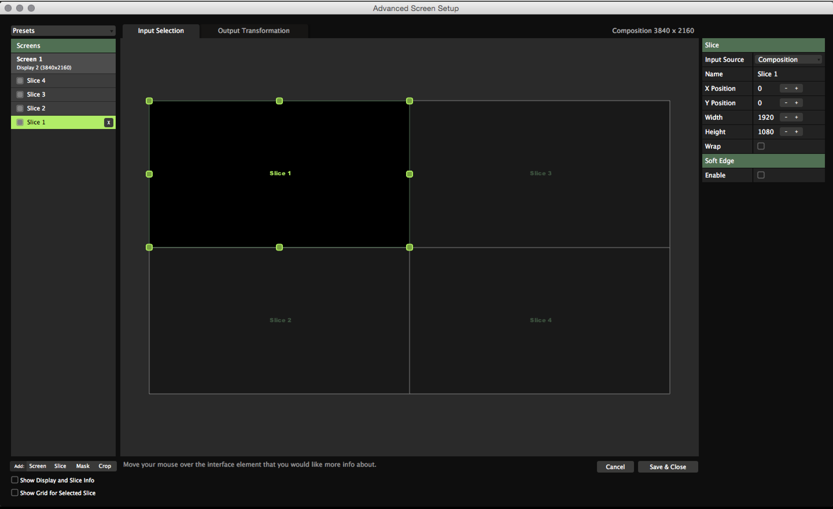

The Datapath X4 will act as if you had 4 different outputs. The only trick is that in the advanced output, it will be one screen with 4 slices. Here is it what it would look like with a 3840x2160 comp and four 1920x1080 outputs:
Then in the datapath interface you'd set the four outputs to match these four areas and you'd be set.

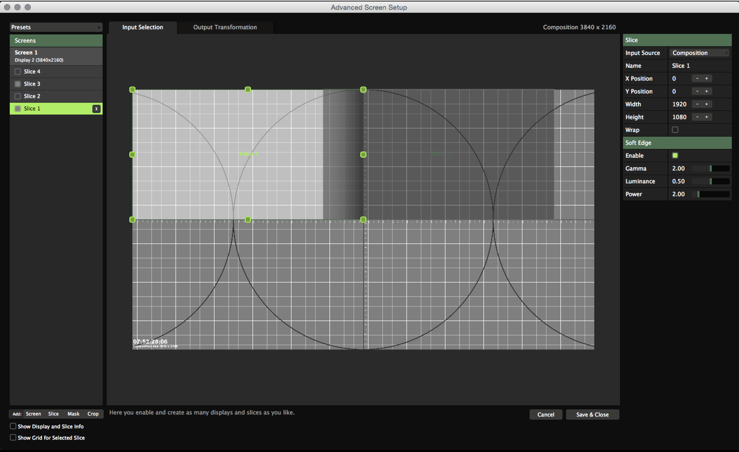

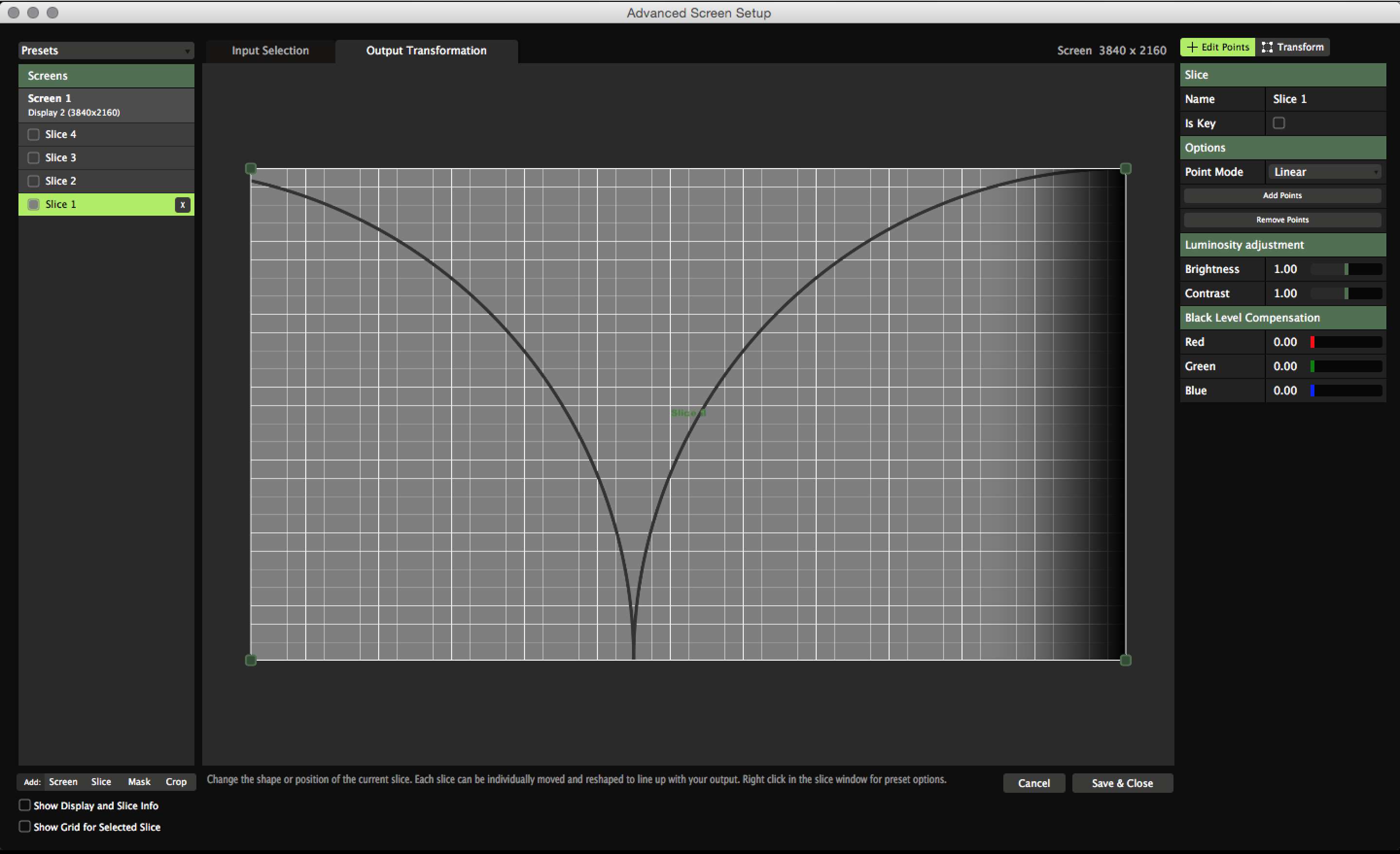

Now if you wanted to do blends, you would treat the four slices as if they were actual outputs. Take a look at these 2 screenshots where Slice 1 & 3 have a blend area: Now, if you choose to use a desktop with a GPU, find one that can handle 5 outputs and you'll be set. A lot of AMD cards can handle 6 outputs with MST and a couple can handle 6 straight out (HD5870 & 7870 Eyefinity 6). I have used the HD5870 Eyefinity 6 on many projects and they handle XGA pretty well but make sure you have only 2 passive adapters.
