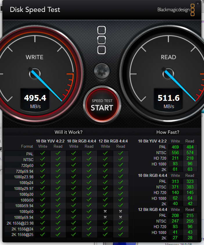

steve33 wrote:you can see the read speed on the right (510MB/s) and you obviesly dont know what your talking about.
it says that i cannot Write 1080 50P 12 bit RGB which is 550MB per second!
1080 25p DXV file is like 12MB per second, i can play 40 DXV clips at a time with my hard drive!
please do not reply if you do not know what you are saying.

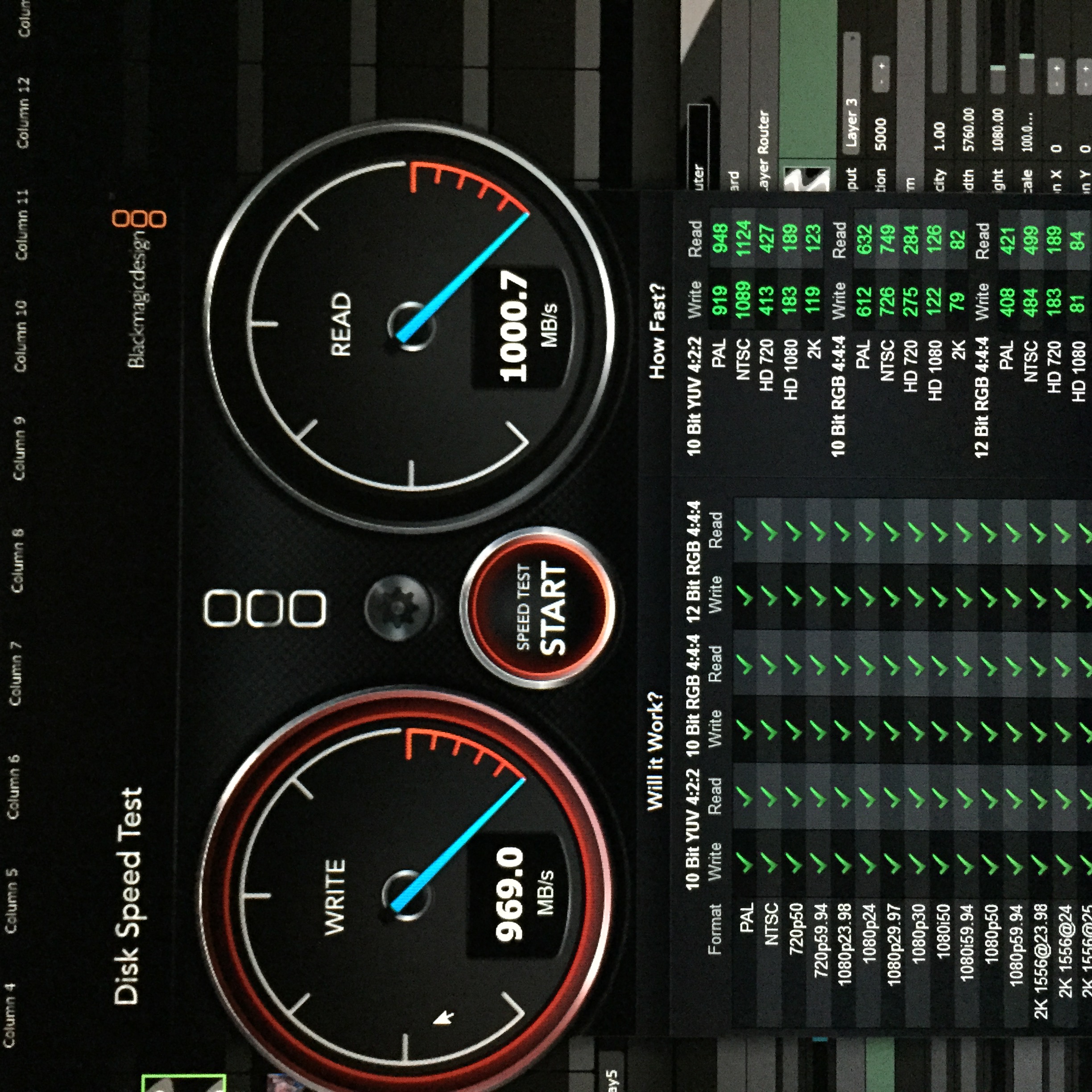

I think you need to be a little more respectful of other contributors in your replies and assume senior contributors like dirtyjohn_lv know what they're talking about!
Here is what your Blackmagic Speed Test should look like when it has all the read information not just the overall Read speed at the top:
as you can tell your test is missing all the Read information! For instance, as per the last column on the right, my system can read 2K 12 bit 4:4:4 from my SSD at 45FPS.

but looking at results of 500m/s and saying that i cannot play HD files is unprofessional and could be deceiving for other members reading this post. i stopped the test before it finished calculating the read data but you can still see the read speed and that is whats important, not the uncompressed files handling.

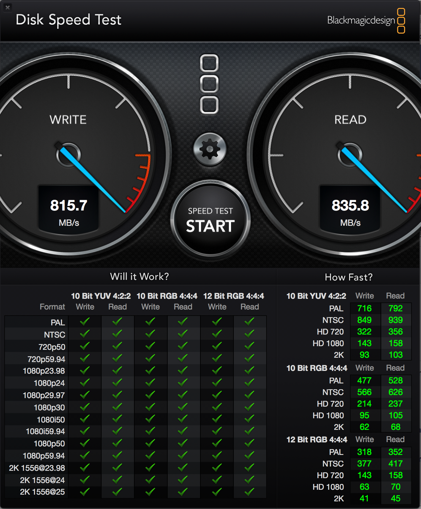

Ok, if you insist, here are the obvies results:

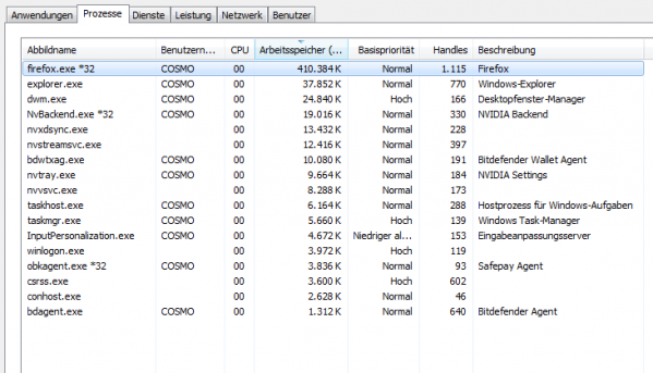

What about your System processes?
Something like this?!
In my case I can force stutters with some system load in background.
Another question to your BIOS...is any kind of eco mode disabled?
greetings

cosmowe wrote:What about your System processes?
