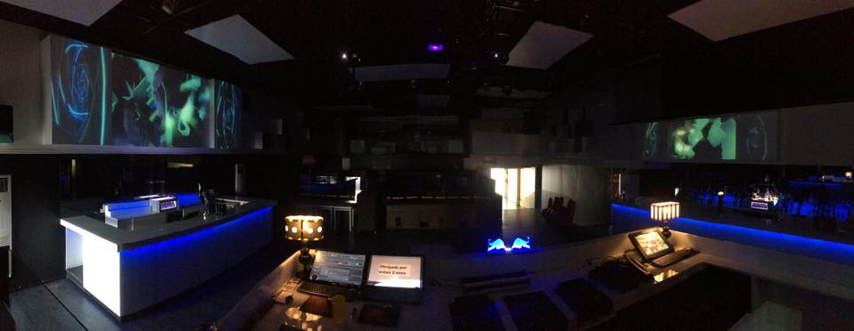

PANORAMIC

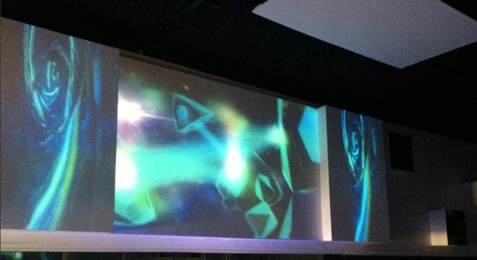

1 WALLThe setup is: 2x Projectos for the big wall: 2560x800
Layer 1 and 2 Composition (center)
Layer 3 (sides)

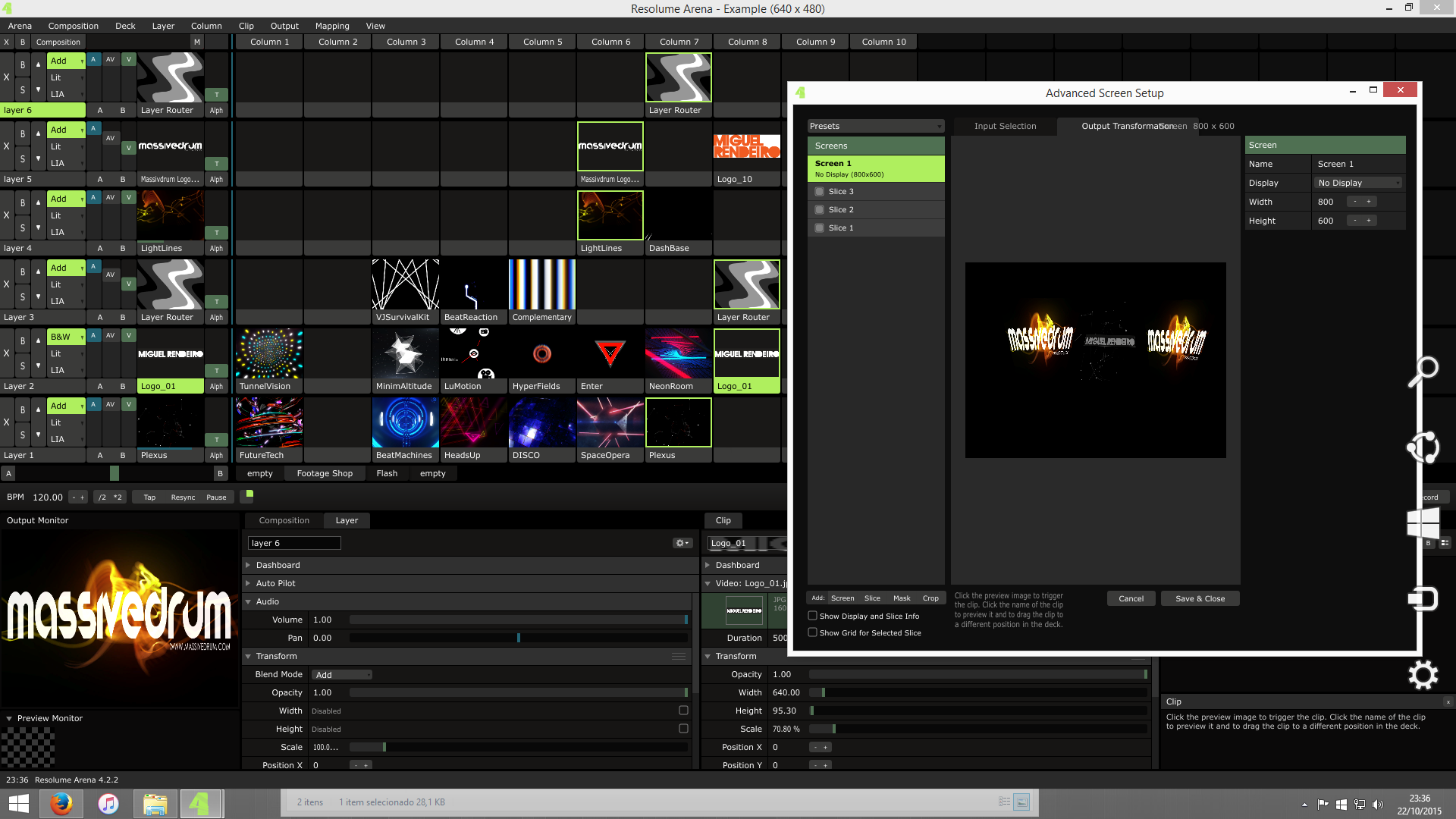

Output settings is.
2 Slices Blending for center.
1 Slices for each side
The anwser is?
PS: AFTER SOME TRYs WITH LAYER ROUTING IVE DONE THIS IN MY HOME PC:
Is this the correct way of doing it? well, alot layers >.<
