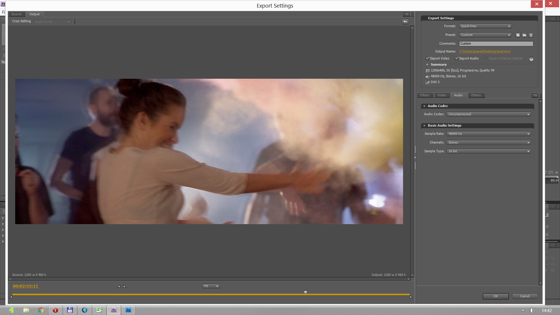

Re: problem with smooth video playback with sound
What codec are you using for the audio track?
svoboda
Posts: 39
Joined: Fri May 13, 2011 15:50
Location: Poland / Gdynia
Post by svoboda »
Hmmm. That looks correct to me. Could you maybe send over the file?
