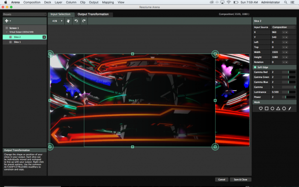

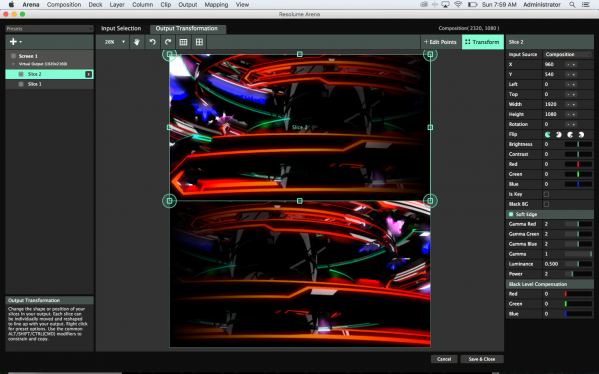

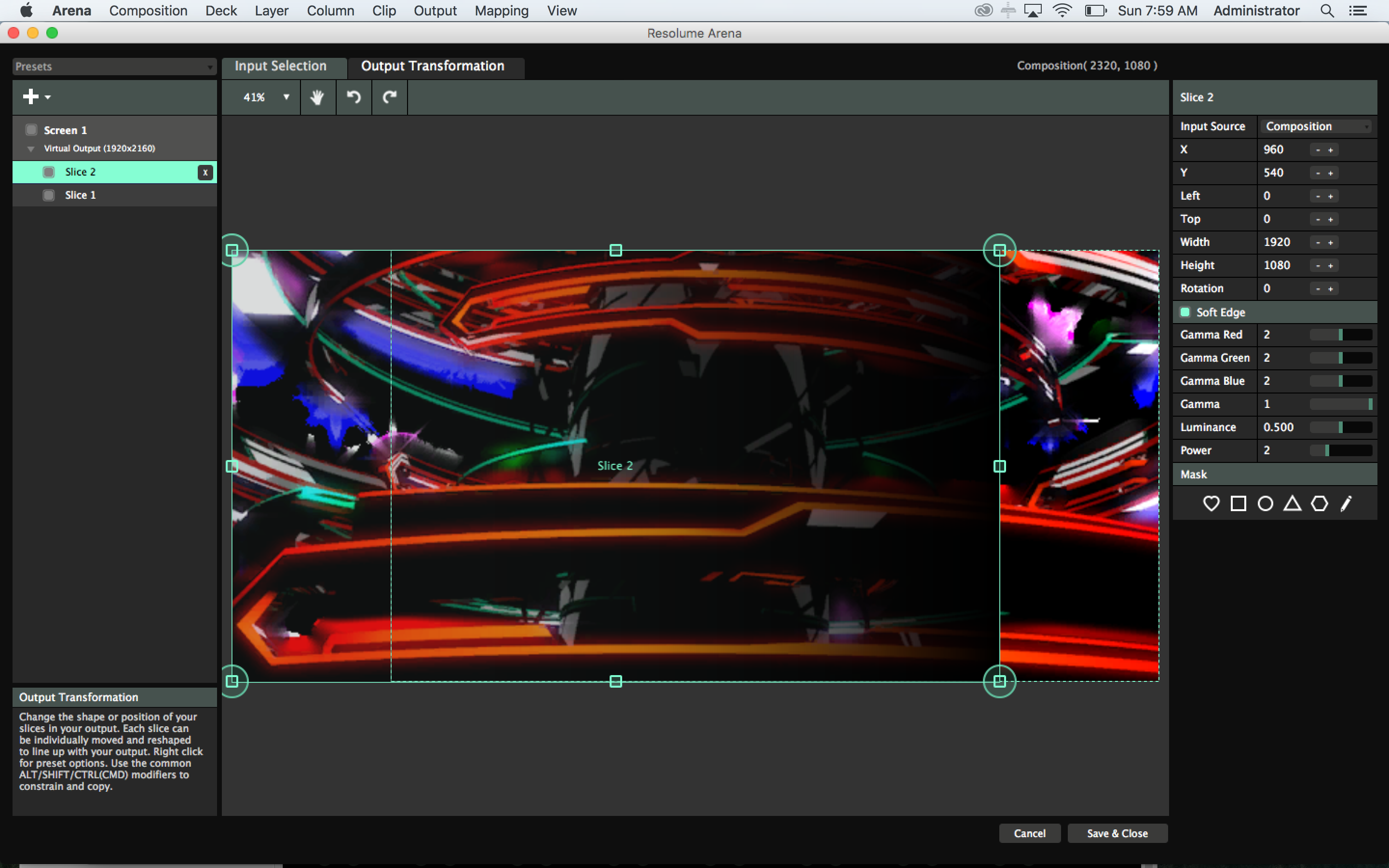

When I have two projectors overlapping side-to-side, with a very large amount of overlap (say 40% although I'm not in front of the setup right now and can't check), the edge that Resolume tries to blend becomes the bottoms, rather than the sides. I have a very big museum installation job that is coming up, for which this is a critical problem. I'm covering walls that are slightly too long for individual projectors, but close enough that they are overlapping quite a lot. The screen designs and rigging points are already set. I need to figure out some way to resolve this issue. Anyone have any advice?

Yeah, we did some work on this on the 5.0.2 release. You might want to make sure you are running the latest version.
Re: Blending The Correct Edge
I did some testing in 5.0.4 and it seems to be working fine with a 1520-pixels blend area with two 1920x1080 outputs.

Yup, updated to 5.0.4 and the problem seems to have been resolved. Thanks guys.
