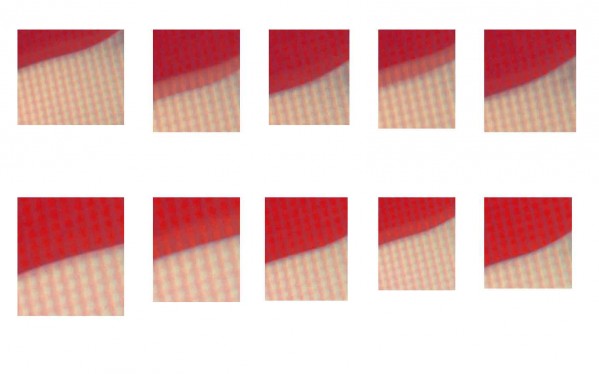

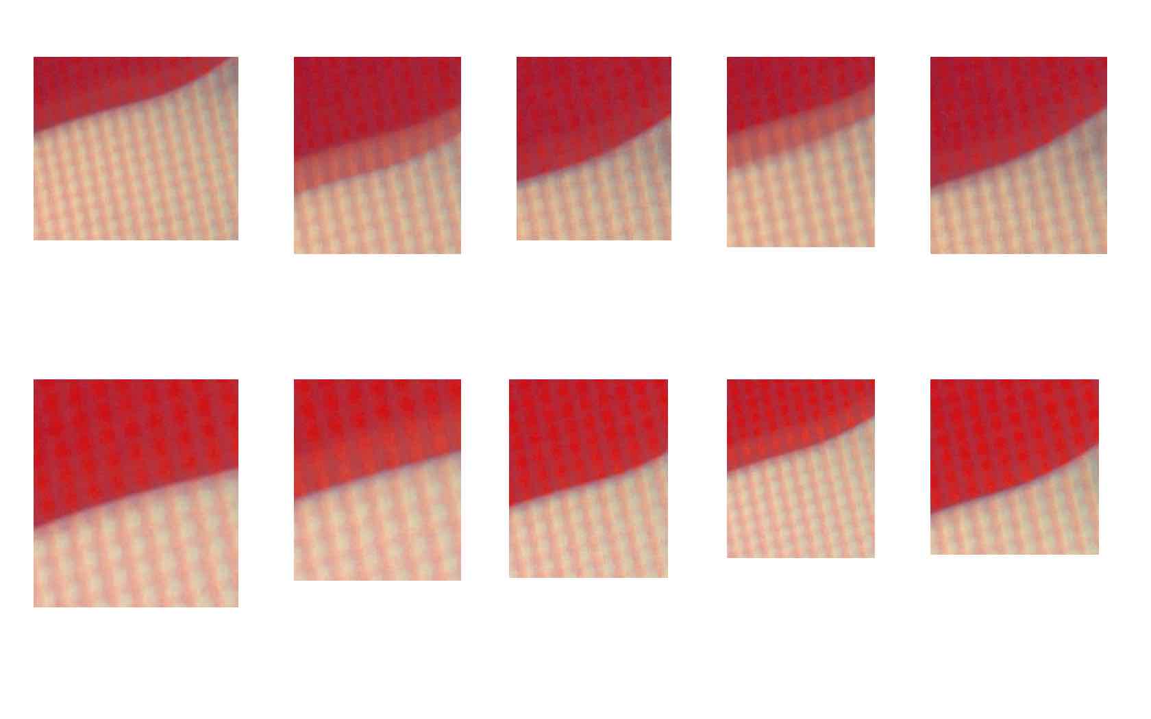

I have attached a cropped image showing an edge moving (its actually travelling towards the bottom of the screen). Here you can see the resolume playback (top row) has a fainter trailing edge, which is about 100px wide...very noticeable, and its on almost every moving edge. It makes text hard to read.
On the bottom row you can see quicktime player playing a clean image - altough you can see a faint line on #2. On the quicktime footage, there is such a bended edge on a couple of frames in a 1min video, while on the resolume its on almost every second frame.

Posts: 7781
Re: frames unintentinally blended on monitor
Can you switch the camera to a higher fps like 60p just for a test? that would show every frame the monitor displays.
this still looks like a double frame exposition for me, with the quicktime playback being slightly more in sync.
I'm 99% sure that resolume doesn't do frame blending on the output.
When playing back a 24p footage at a 60 fps monitor, then recorded with 60p you should see one source frame clear for 2 frames, and one for 3 in the recording, (and one blended every 2 and 3 if out of sync)
