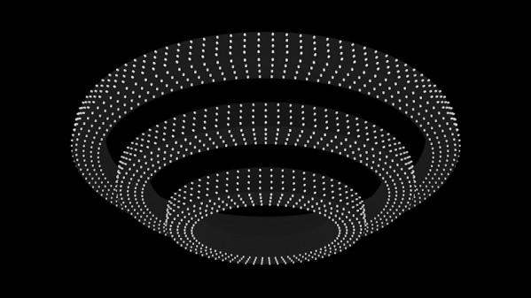

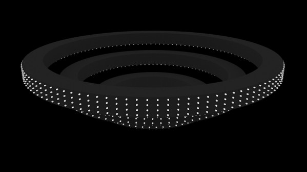

Any advice is welcome even if this means I have to make a custom little program/tool/plugin for this or advice on a LEDpixel controller which can eventually control 7.200 individual pixels. This means 21.600 individual DMX channels which are 43 Universes the least
