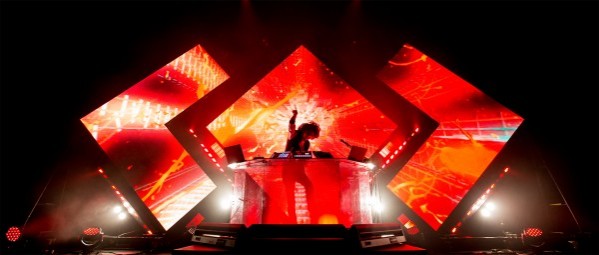

With an on stage setup that baffles even the best in the business, this 22 year old producer has reached where he is because of his focus on the audio-visual aspect of a performance, as a unit.
His stage setup should be trademarked. It’s a diamond with arrow- like shapes on either side.

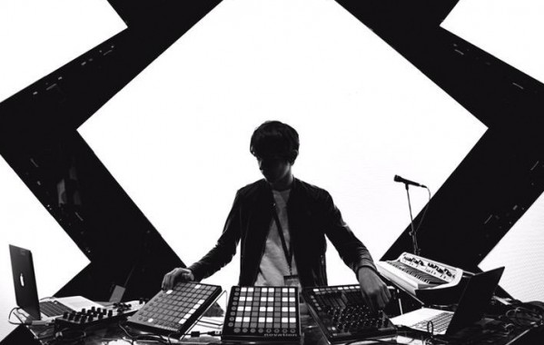

The show is run on two laptops which are on stage with me.
One runs the audio side of things in Ableton and sends MIDI through ethernet in real time to a second, dedicated video laptop running Resolume.
I have two Novation Launchpads to play musical parts and modify existing stems, one Novation Launchcontrol XL to handle some additional fx and general controls (including tempo) and a Korg SV-1 keyboard.
There is also a Xone K2 plugged into Resolume to control some video effects.

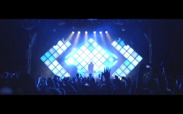

All of the audio clips and parts in Ableton are grouped with matching MIDI clips that trigger videos and effect in Resolume.
All of the editing is done in real time, it's really useful as it means I can edit the video show easily between shows by simply changing the MIDI score.
It also means that I can improvise, extend or shorten a section, with the knowledge that the video show will keep up.

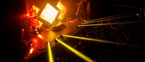

It's intuitive and powerful, the effects are extremely usable and the latest updates in Arena 5 added mapping options that enabled my latest "diamond/chevron" LED setup.
