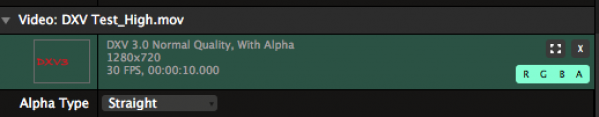

I'm using a video exported from Premiere with DVX3 (High Quality with alpha), and want to layer it with another video. I am not using Advanced mode, I am going fullscreen on the second display.
The alpha channel of the clip is recognised, but I can't use it to put over the other layer.
Am I doing something wrong?

Do you have an alpha channel in your clip (RGBA)? When you preview your clip, do you see the alpha grid in the preview window?

Hi thanks,
Actually, it seems like I don't export with alpha from premiere, even though I put the right settings. I tried with After Effects and it works well.

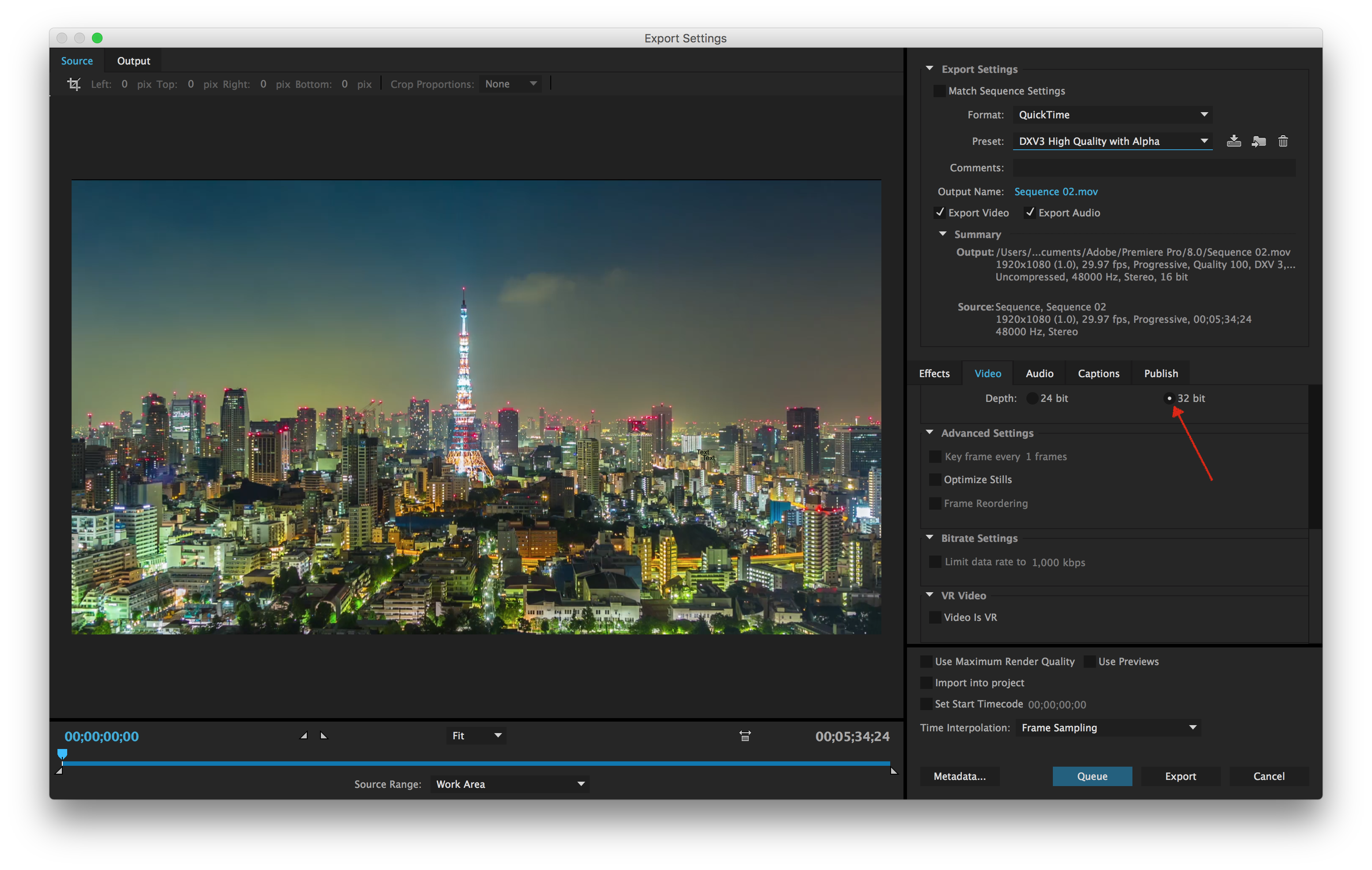

In Premiere, make sure you're using the max rendering depth (32-bit) in the video settings when you render DXV with alpha or the alpha channel won't be preserved during the encoding process.

I've been cataloging all of my content from this last year (over 1TB) and doing a LOT of edits and conversion (mainly in MPEG Streamclip) but for all my Alpha visuals I am using Premiere and AME. I have a LOT of presets for sessions and exports (23.976 - 60 fps @720p AND 1080p) if you would like me to send you a link to add to your presets? presets are for ProRes 422(HQ) and 4444 for Alpha, as well as DXV3. All presets are set for standard export and with Alpha. To repeat what Oaktown has said, Alpha requires a 32bit export to work (sadly MPEG Streamclip does not offer this, unless I've overlooked it somewhere?)
