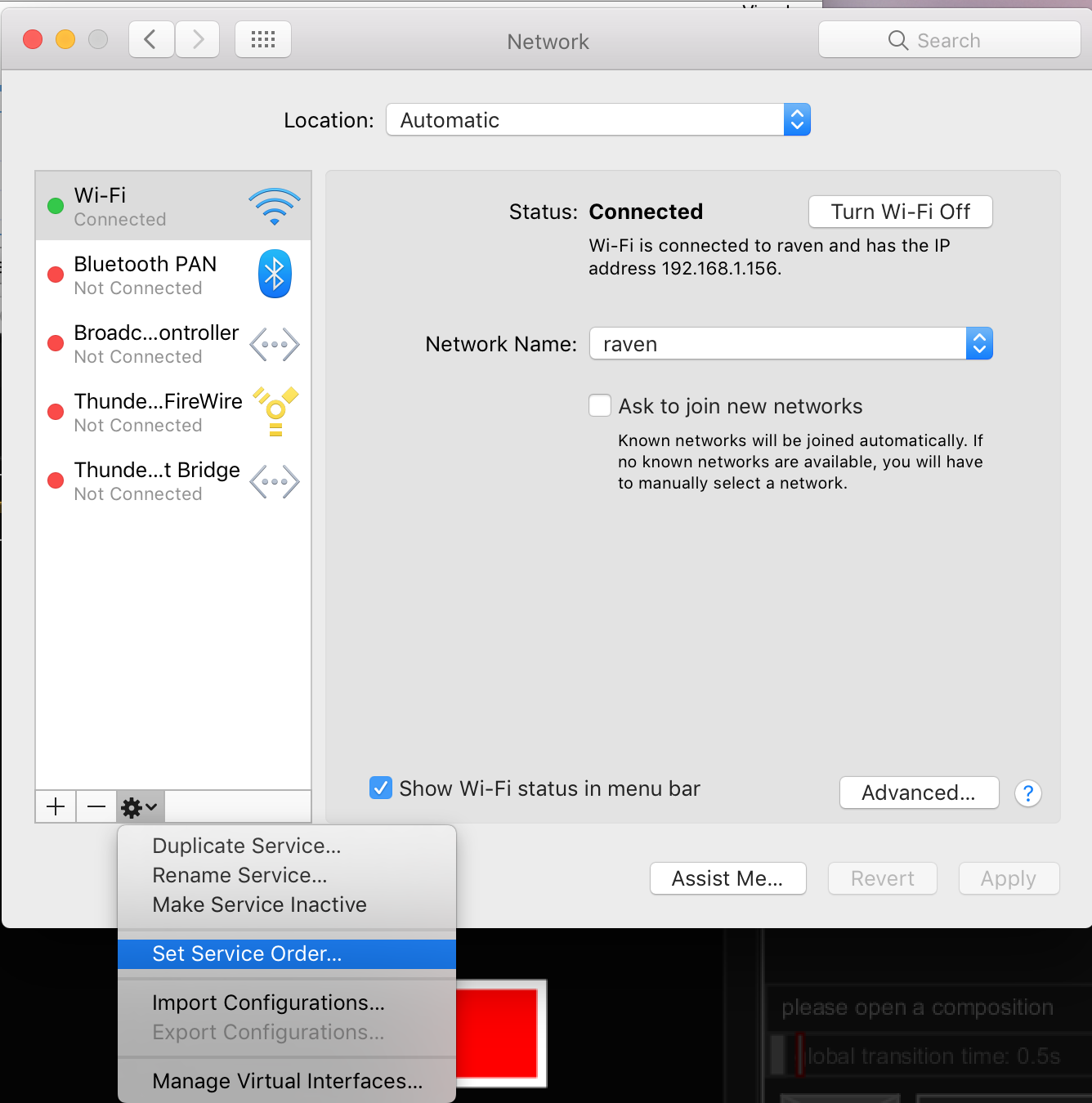

ravensc wrote:How does resolume decide which NIC it will use for the artnet output?
Yes. This. It would be great to able to choose which network interface or use all of them :)
I have an ethernet connection to a wifi router which all my Artnet clients connect to. If I turn the wifi on on my MBP and connect to a different wifi network, then Arena doesn't see the nodes.
The current workaround is to disable my MBP wifi and open Arena. Then enable MBP wifi.
Posts: 7537
Re: Arena 5.0 no DMX output
grivvr wrote:I have an ethernet connection to a wifi router which all my Artnet clients connect to. If I turn the wifi on on my MBP and connect to a different wifi network, then Arena doesn't see the nodes.
I have done some testing.
I think you have the wireless device as default route in your networks settings, and the wireless network you joined has the same IP subnet/range as your wired connection, so even if you would set an ip address to unicast, the packet would try to go to the default route.
The solution for this is to change your routing table to have your wired interface with higher priority.
if you are on mac, then you can do this in network settings, click on the settings icon below the interface list and select the "set service order", then reorder your devices by dragging them.
In windows, a lower route metric means higher priority, so you want your wired connection have a higher priority.
