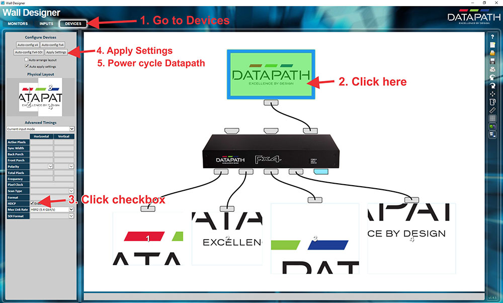

Got some problem with HDCP on Macbook - some led receiving cards from LINSN are not compatible (NovaStar works great). No problem with PC Rack - everything is working.
I know that there is a workaround for HDCP issues inside Datapath software, just need some free time to figure it out.
Problems with HDCP=red screen. So if you see red screen - disable somehow HDCP.

Regarding HDCP problem: i missed one step, so could not find right checkbox in software.
Everything is great now
