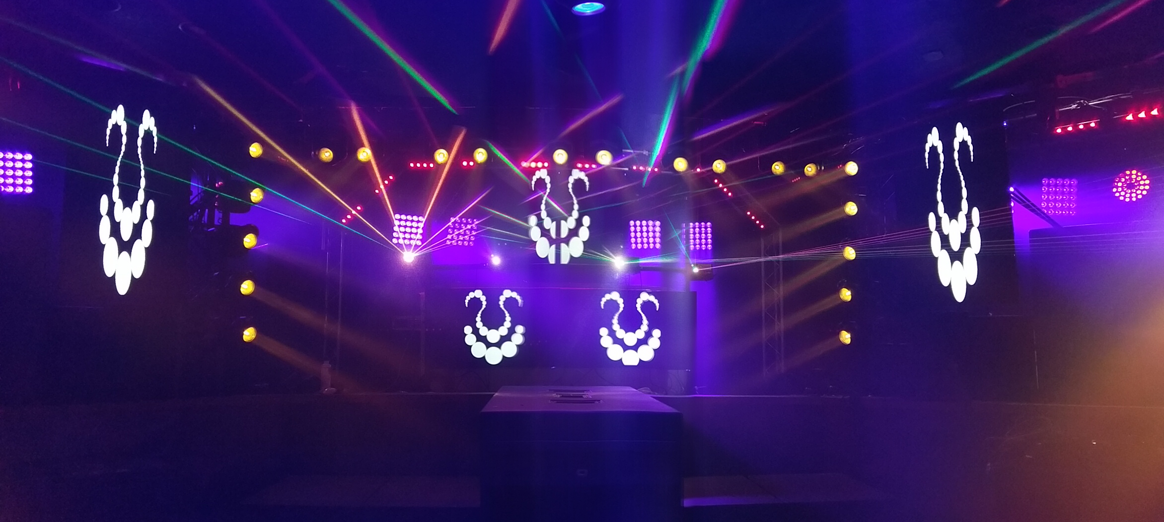

Heya, first time poster! smiley here from ATL
SmilebotProductions on the vizzys! Anyways a club here had me install 6 tvs (some of them verticle) for their NYE show with rusko (whom i did the vizzys for)
what im trying to do tho is have the far right and bottom right TVS image flipped so its all symmetrical, if that makes sense.. but if i do that, whenever i pull up the logos they are backwards.. so im tryin to figure how to keep the logos goin normal direction while the other layers arent flipped... and i cant flip the clip or it is backwards on the other ones .. does this make sense? i cant post the vid i have to show what im tryin to say

Nice picture
I think I get what you mean..
You can make a copy of the slice(s) you mirrored. Now unmirror them. Now select your logo-layer as input for this slice.
The down part of this method is that the blending modes won't apply for the logo and the image under it since it's on a separate slice that only takes the layer, without this layer being mixed in the composition.
Does this make sense to you?

yea it does..thanks.. is there a way to make a layer so its separate from composition ? or is it pretty much either 1 layer or all of em?
