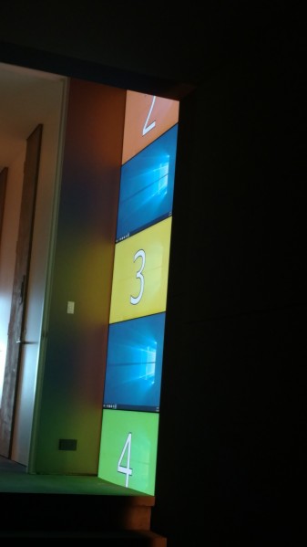

Can anyone explain to me from the photo what might be going on? I've recently done a clean installation of windows 10 Pro x64 with all the updates on a custom media server. Upon loading either 5 or 6 somehow they are overlaying the same output to the same screen with different connections? Prior to reinstalling everything worked fine on all 13 screens. Resolume was installed clean after all updated drivers. I've changed all the screens to different output connections with the same result.
2x Xeon 14core, 4x 1080 TI, 128GB DDR4
12x output screens for wall +1x extra output for control. (2 outs removed to show for this test)

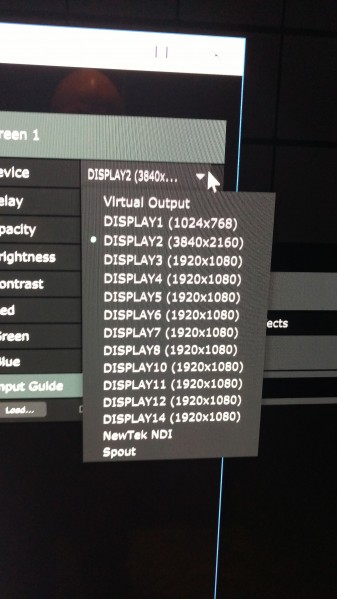

Arena 5 will output to screens 1-7 ok and overlays all the rest of the screens split on 7+ 8. Photo are the only outputs available in 6? Where have my outputs gone? How can my 4K display2 (control screen) output to screen 1 when enabled?

display1 = dsub unused
display2 = 4k control screen (center) = Arena 6 outputs => display3 when enabled (control screen still active)
display3 = 1080p (#1 Top Lft Screen) = Arena 6 outputs => display5 when enabled
display4 = 1080p (#2 Mit Lft Screen) = Arena 6 outputs => display7 when enabled
display5 = 1080p (#3 Cen Lft Screen) = Arena 6 outputs => display10 when enabled
display6 = 1080p (#4 Mib Lft Screen) = Arena 6 outputs => 1/4 overlay display10 + 3/4 display11
display7 = 1080p (#5 Bot Lft Screen) = Arena 6 outputs => nothing when enabled
display8 = 1080p (#6 Top Rgt Screen) = Arena 6 outputs => nothing when enabled
display10 = 1080p (#7 Mit Rgt Screen) = Arena 6 outputs => nothing when enabled
display11 = 1080p (#8 Cen Rgt Screen) = Arena 6 outputs => nothing when enabled
display12 = 1080p (#9 Mib Rgt Screen) = Arena 6 outputs => nothing when enabled
display14 = 1080p (#10 Bot Rgt Screen) = Arena 6 outputs => nothing when enabled

Turning off display scaling in windows should fix this.
Re: ARENA 5 & 6 OUTPUT OVERLAY ISSUES
That did not solve the problem. I still am only getting 6 of 12 available outputs in Resolume 6 with the current windows update. I've rolled backwards and forwards drivers with fresh installs of 6 each time same result.
Update: I have been able to remove 6 cleanly and the outputs returned to normal in Resolume 5. Resolume 6 still only allows 6 of 12 outputs.
