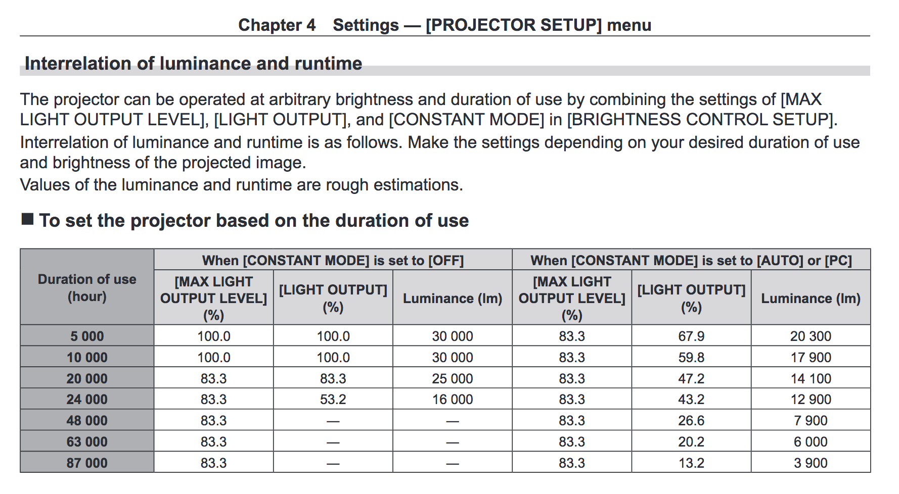

I'm assuming these were brand new and rental units, correct? Did you check to make sure the [Constant Mode] setting in the [Brightness Control Setup] was not set to [Auto] or [PC]? That would have taken the brightness down to ~67%

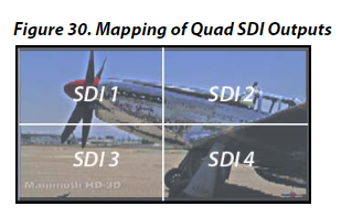

@ Arvol, here is how the 4K is broken down into 4 quadrant
Capture 2.PNG (79.87 KiB) Viewed 13561 times

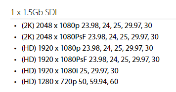

@ Meptik, it looks like you should be able to do 1080i

Oaktown wrote: I'm assuming these were brand new and rental units, correct? Did you check to make sure the [Constant Mode] setting in the [Brightness Control Setup] was not set to [Auto] or [PC]? That would have taken the brightness down to ~67%
With the "old" 21K you only could set it up one time (per Lamp set) and cant change it later.
Is it now possible to change between the mode?
This was for the laser units.

Oaktown wrote:
I know, so the new laser models can change the operation mode multiple times?
