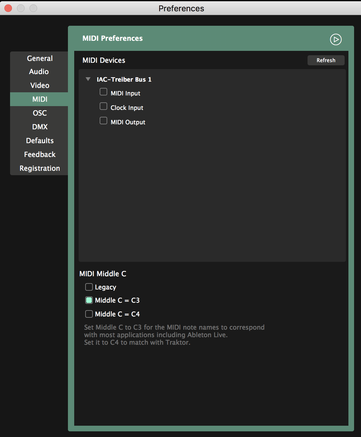

Preferences
Preferences

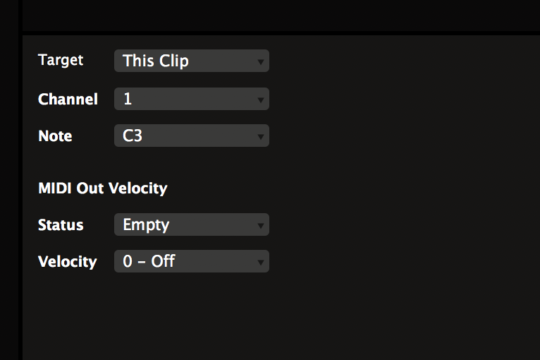

Midi Trigger
Midi Trigger
Bildschirmfoto 2018-01-27 um 18.41.40.png (97.85 KiB) Viewed 7773 times
Midi Pref
Midi Pref

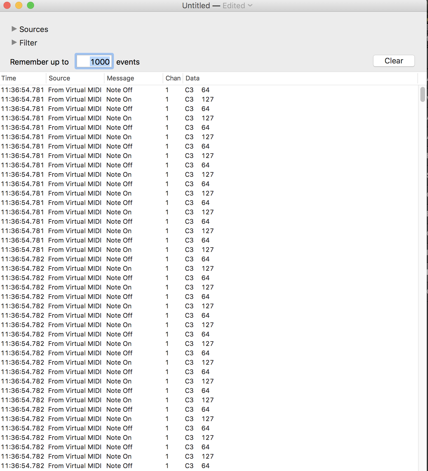

Show us what your sending in the midi monitor.
I still think your sending midi out and creating a loop. :p

It seem like the problem already occures in Logic.
I am getting the same Monitor with Resolume switched off.
So there has to be a loop inside of Logic already.
Thanks for that. The Monitor was a Tool I did'nt knew before.
