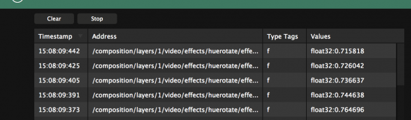

hue rotate not working on TouchOSC
Re: hue rotate not working on TouchOSC
looks like touchOSC is sending empty addresses, that's why it is not working.
Do you have any idea perhaps that why could this be? I don't understand why is this happening since i'm using correct addresses in the editorZoltán wrote:looks like touchOSC is sending empty addresses, that's why it is not working.
no, but we could look at the touchosc template if you can share it.
Sure thing, thanks a thousandZoltán wrote:no, but we could look at the touchosc template if you can share it.
I'm getting the same problem when I use TouchOSC but if I copy the string to another OSC program it works no problems.
I checked with OSCTestApp and the problem seems to come from TouchOSC not Resolume.
Ok, thank you alot. Do you have any recommenditations what app i should use that works? I see there is this lemur app which seems promisingOaktown wrote:I'm getting the same problem when I use TouchOSC but if I copy the string to another OSC program it works no problems.
Let see if Zoltan ends up with the same issue and if he does, I would suggest you contact Hexler directly to see if they can figure out why it's sending an empty string.
https://hexler.net/contact
Tested touchOSC on Android, and it worked fine.
works for me too, I just synced up the template you sent to my phone.
Didn't change anything.
Ok, strange.. Maybe I have to contact hexler about this
