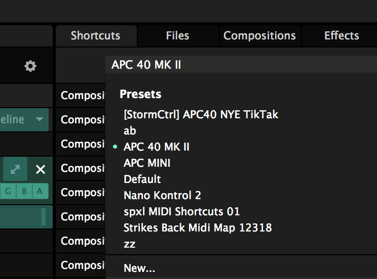

mrclean808 wrote:Im assuming its naturally selected when connected?
No it's not.
You can select it manually entering Shortcuts - Edit Midi.
Then in the shortcuts panel in the preset list there is the APC 40 mkII preset.

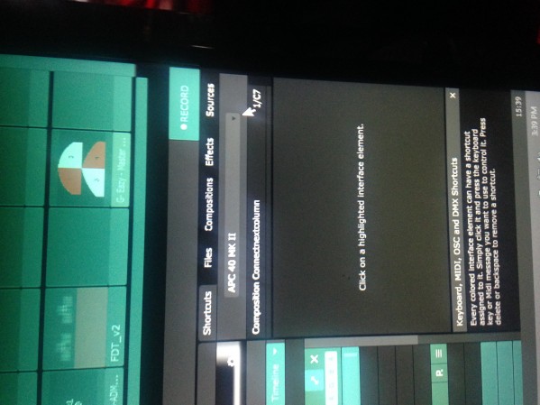

It seems that my turning on midi out disables the APC 40. It use to work fine and then stopped working.
As long as I don't turn on midi out, I can receive midi from the APC 40

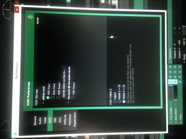

Re: APC 40 MKII midi issue
Could you send us a screenshot of your midi settings?
Which Resolume version are you using, on which OS?

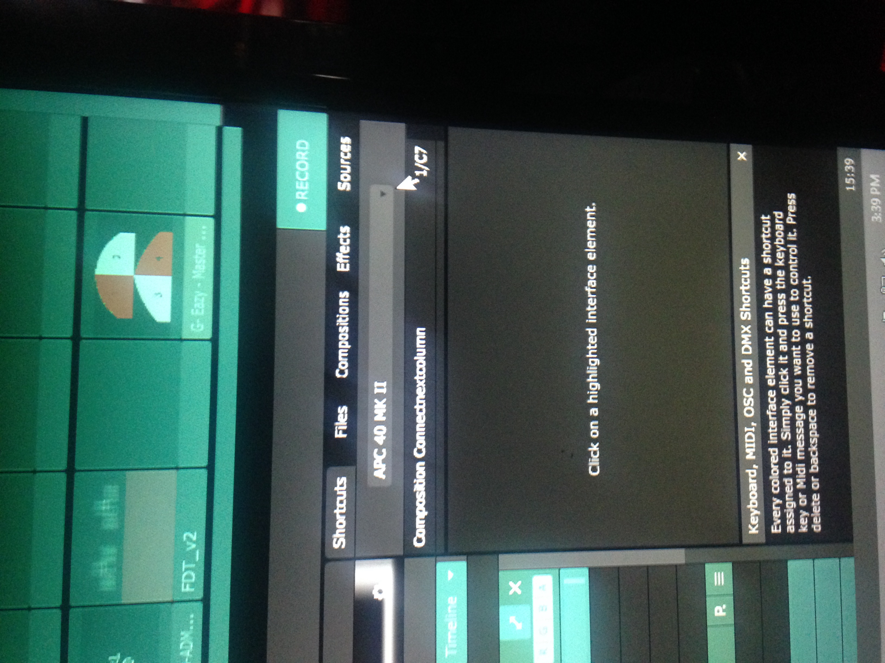

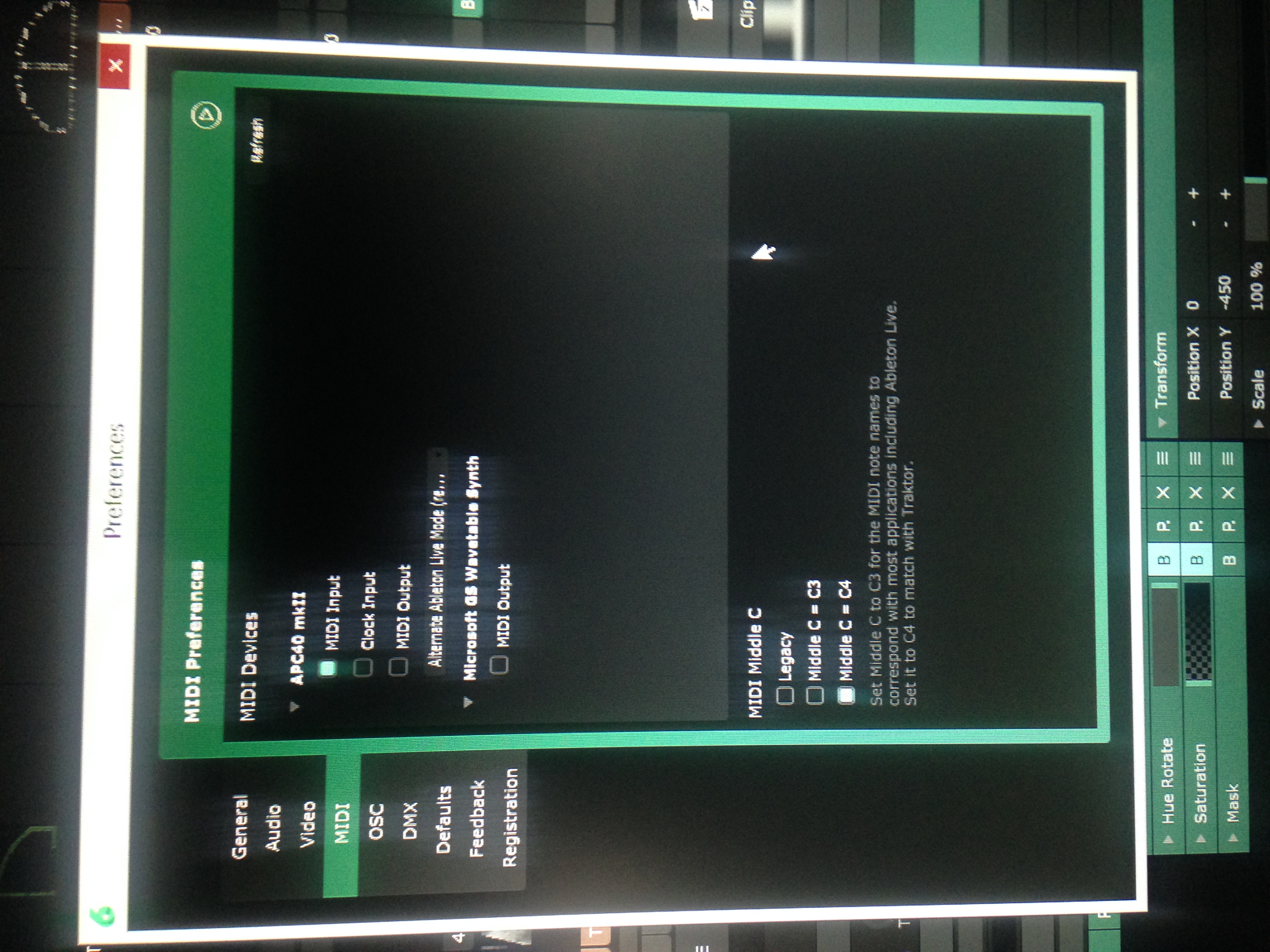

thanks for asking. I'm running 6.05 on a PC running windows 8.1pro
The touring rig is not online so I'll share photos from my phone.
