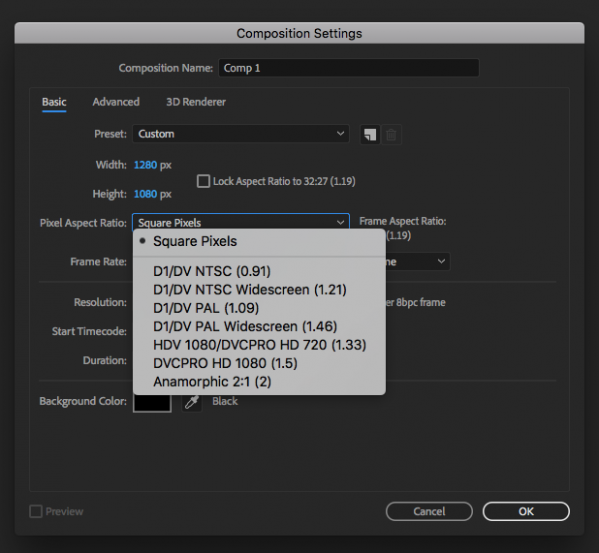

Re: Ingesting Media with incorrect aspect ratio
I'm 99% sure these files are encoded with a non-square pixel aspect ratio. This is indeed a problem on < 6.0.7 release, and should be fixed in the upcoming 6.0.8

I think youre right with the media encoder and square pixels. I ended up managing to get it to work rendering to DXV in after effects. I think I should be alright in that regard.
