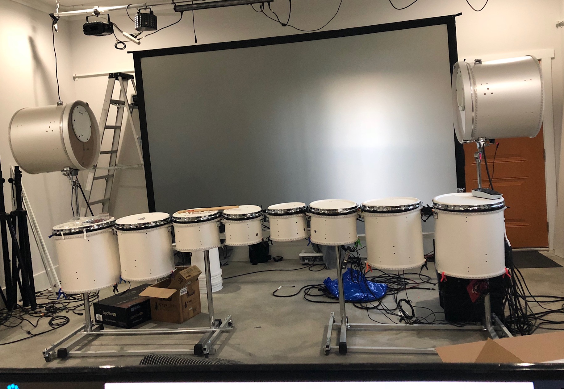

Hey Arvol!!
Here's my set up and layout - so you can (hopefully) specifically help me!
each drum has a 32 pixel fixture. Top and Bottom. So, when I hit the 6th fixture, I can't add a 6th fixture of 32 LEDs. (Where this gets confusing to ME is that in mad mapper, not to start an argument, I could address fixture #6 at 1:481, and it would autocomplete the finish to 2:66.) So, In the past, regardless of where it was patched, It would be one solid fixture.
As I'm sure you notice in the other post - I Think I will need to rely heavy on Slice Transforms, and right now, I'll have two slices for one fixture. Which, is manageable. BUT< with resizing and anything beyond the initial setup, I just had to do 'more'. If I could link them together, or something... it would be great.
I am running the LEDs in on the bottom left and bottom right of the drums. I inject power half way though, then again at the end. Stopping a fixture early, and controlling with a new universe can't happen with my setup. SO, i'm just trying to set my infrastructure up as efficient as possible.
For your questions, Yes. Computer to 'controller hub' one ethernet. Out of That, I have 8 cat5 out. Each controls TWO universes via their own mini controiller. Cat5 in, +, gnd, Data out. I power those, and the LEDs with the same power supply.
Im running each pixel as its own fixture, because it looks awesome. SO, your post was helpful, but I do understand most of that. Its more how to physically implement what I am trying to do as best as possible. I know its possible - but it seems my questions are far beyond the manual.
:o)
Does this clarify MY end a little better?
THANK YOU
V
