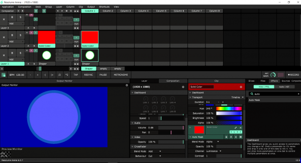

100% Saturation/brightness/alpha colors begin to become transparent with a full contrast automask around hue value 240.

Please post a screenshot of a setup showing this, so we can recreate what you see.

Sure thing! Here's a solid color with a full contrast automask above a layer with a white/green shaper. The solid color's hue is 240. The automask paired with that hue causes transparency, while with any hue outside the 230-250 range, no transparency is caused.
