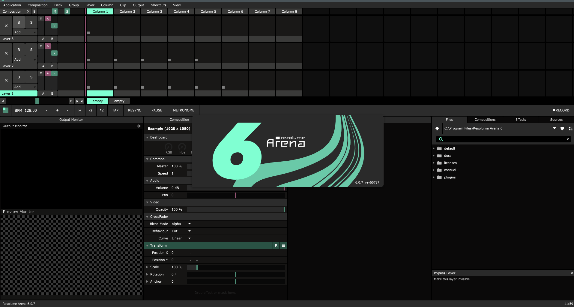

Having a similar issue.. Resolume 6 won't open properly, Just hangs on the opening screen as shown in the attached image.
Running latest windows 10 and nvidia drivers. System spec as follows:
Intel I7 6850k
2x Quadro M4000
Asus X99 Deluxe MB
Smasung 950 evo pro
Intel PCIE SSD 750 series.
Any assistance would be greatly appreciated. Got a show coming up this weekend.. Have never experienced something like this. Machine had been running 6.0.2 fine then just randomly started having this issue. Updated everything but with no improvement.

Re: Resolume 6.0.7 have to force quit!!!
Sent you a PM,Foresight wrote:Having a similar issue.. Resolume 6 won't open properly, Just hangs on the opening screen as shown in the attached image.
This looks more like viewtopic.php?f=12&t=15939
