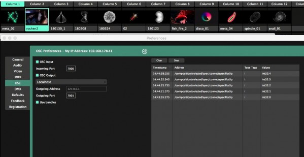

I am sending the OSC message "/composition/selectedlayer/connectspecificclip" to Resolume Arena (v. 6.0.7 on Mac OS) to select a certain clip of the selected layer. It only works, if I am sending the integer values 0 or 1 along. The clips in column 1 or 2 are being activated accordingly. Only if I send integers bigger than 1 along, nothing seems to happen in Resolume.
I added a screenshot showing the OSC messages coming in.
Does somebody have an idea what the issue might be? Did I miss something?

Thank you for letting us know, I have created a ticket (11386)

Yeah, that's broken too. I have created a ticket. (11403)daan.hzndnk wrote: Fri Jun 22, 2018 18:03 HALP!

Going back to 6.0.6 should work if you need this function.
