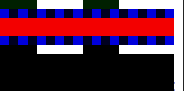

I've attach corrupted view of this file, and file itself.

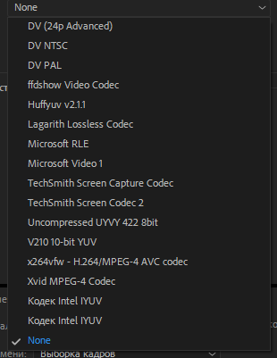

Codec is h264. I've tried uncompressed AVI with same size - no luck.

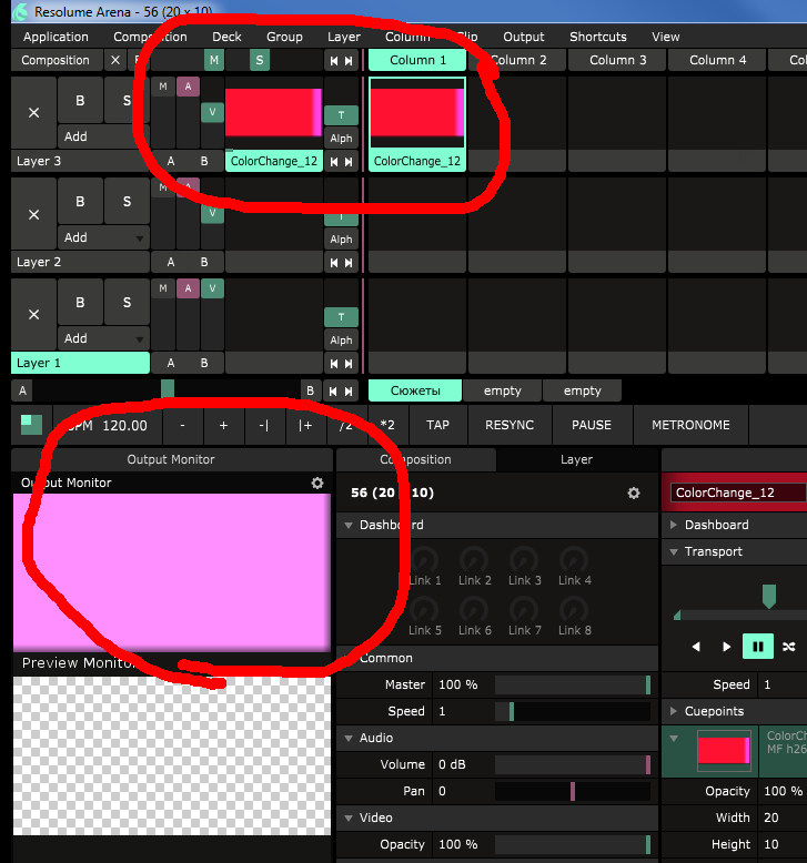

I think it's the resize algorithm.
How does it look on your actual output?

Zoltán wrote: Wed Jul 25, 2018 16:49 How does it look on your actual output?
I've attached videofile (in my first post), so you can see it.
Also i've attach a picture. I try to control color only with one pixel. So, that is why, it's so small.

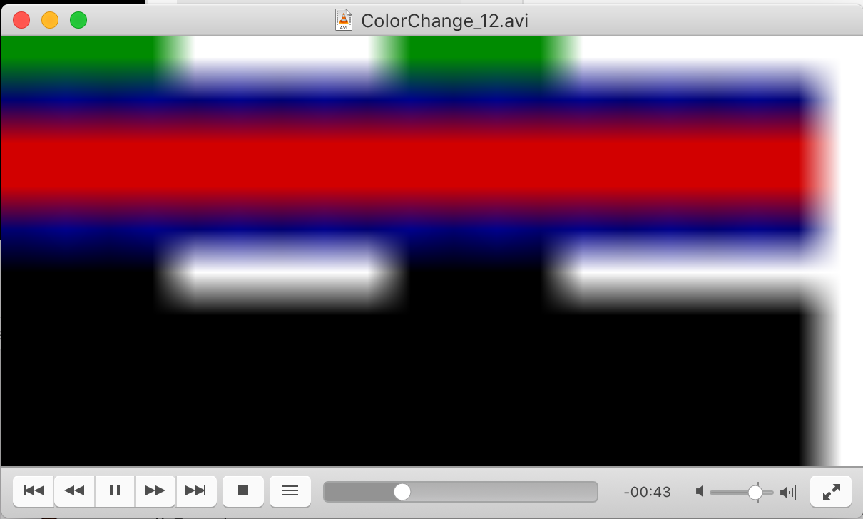

on mac, in VLC your file looks like this:
So, the Output monitor will show you the texture upscaled, but your actual output could look just fine.
Also I don't see any pink frames in the video, so you have either a different file loaded in your screenshot or the file is in an unsupported format.
On my mac the avi you sent does not load at all in Resolume, but that's expected.

Zoltán wrote: Thu Jul 26, 2018 10:14 on mac, in VLC your file looks like this:
Exacactly as it must. (If switch off interpolation, it will be sharp lines\pixels).
Look. i tried all these codecs, and none of them "works with Resolume at 20x10px"

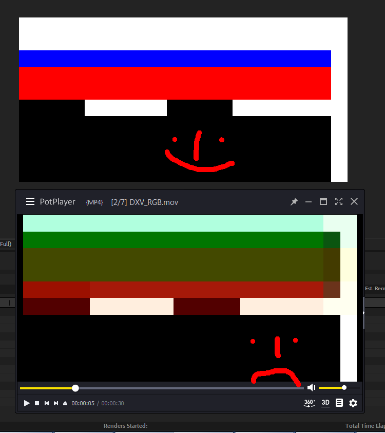

I installed DVX codec, it OPENS in Resolume, but it produce corrupted colors.
The question is: Which codec i must use with videosize 20x10 for proper understanding it in Resolume?
Re: Video file 20px x 10px appears corrupted
The codecs you're trying don't work because you're using the .avi container. We can't open your file on any application except VLC. After effects can't, Premiere can't, Final Cut Pro can't.
Just go with mp4 or mov.

Joris wrote: Thu Jul 26, 2018 10:56 The codecs you're trying don't work because you're using the .avi container. We can't open your file on any application except VLC. After effects can't, Premiere can't, Final Cut Pro can't.
Anyway VERY strange behavior
1. Mov did the trick, but "uncompressed" or "animation" codecs produce quite large files. Somebody knows lossless mov codec with better compression?
2. Mpeg4 (XVID) codec works, but not in even cases. For example frame 20x10 (IN RESOLUME) not works, but 16x16,32x32, 16x32 e.t.c. works. But it produce LOSSY colors. i.e. RED #FF0000 can be #FA1218 and go on. For perfect lighting Mpeg4 not suitable.
Or maybe somebody knows losless XVID settings, or another Mpeg4 codec?
3. h264 works 50%\50% mostly on big files. I still not figured rule.
Anyway, support of h264 codec will be very big step.
In common, i need color-perfect pixel-per-pixel (small filesize) solution to use in Resolume.
